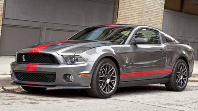

So I’m contemplating on changing my 2011 whippled 5.0. I am trying tomdecode between an ‘11-12 GT500 or a boosted ‘15 5.0.
I believe the ‘11-12 GT500 comes with a better black taking more boost, hence making more power. The ‘15 5.0 can def. put down power between (700-800 rwhp) on pump gas as i have been reading. (I COULD BE WRONG, please don’t bash me over this “fact”).
Both range the same price (depending on mods of course) a little help will be will appreciated.
(PICS FOR ATT)
