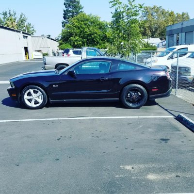

So I put just the rears on and it actually looks pretty good for 17s. I know the drag radial is what's basically making it look good. Maybe I'll try putting the front 17s on and see how the look next week when I get back to work. But thanks for everyone's help. Here's a pic!
Check post #9. 17" wheels won't fit over the 13.2" rotors.
