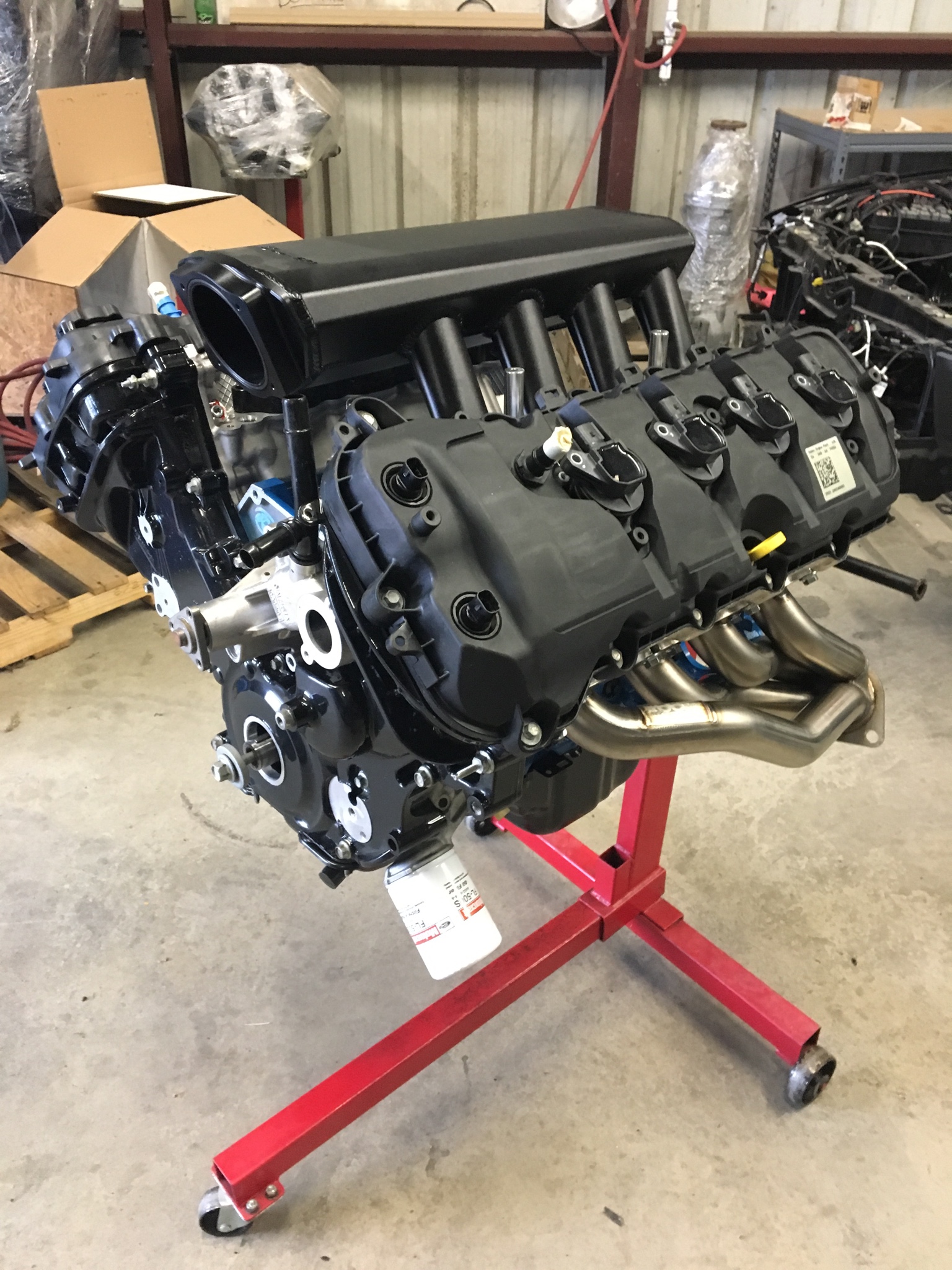

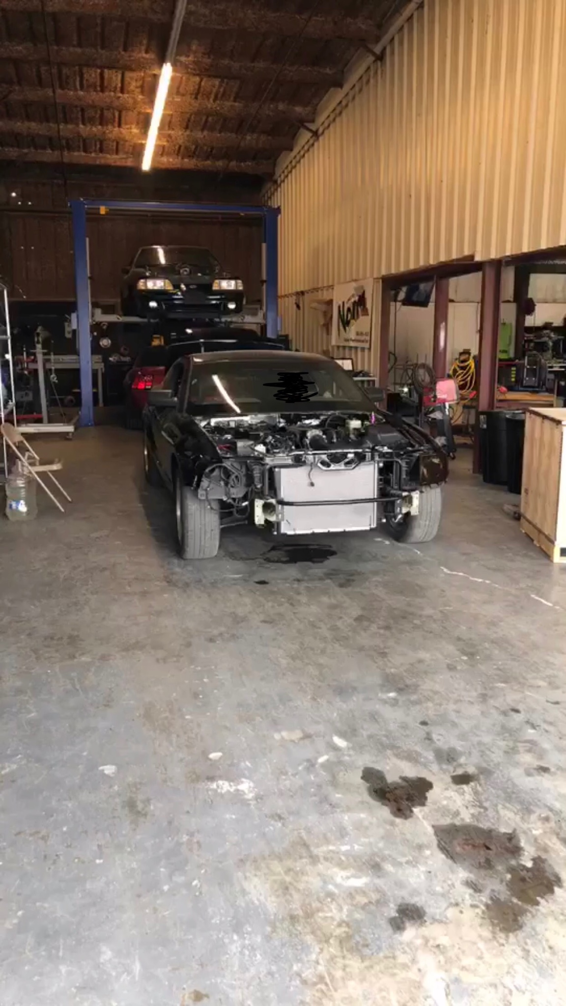

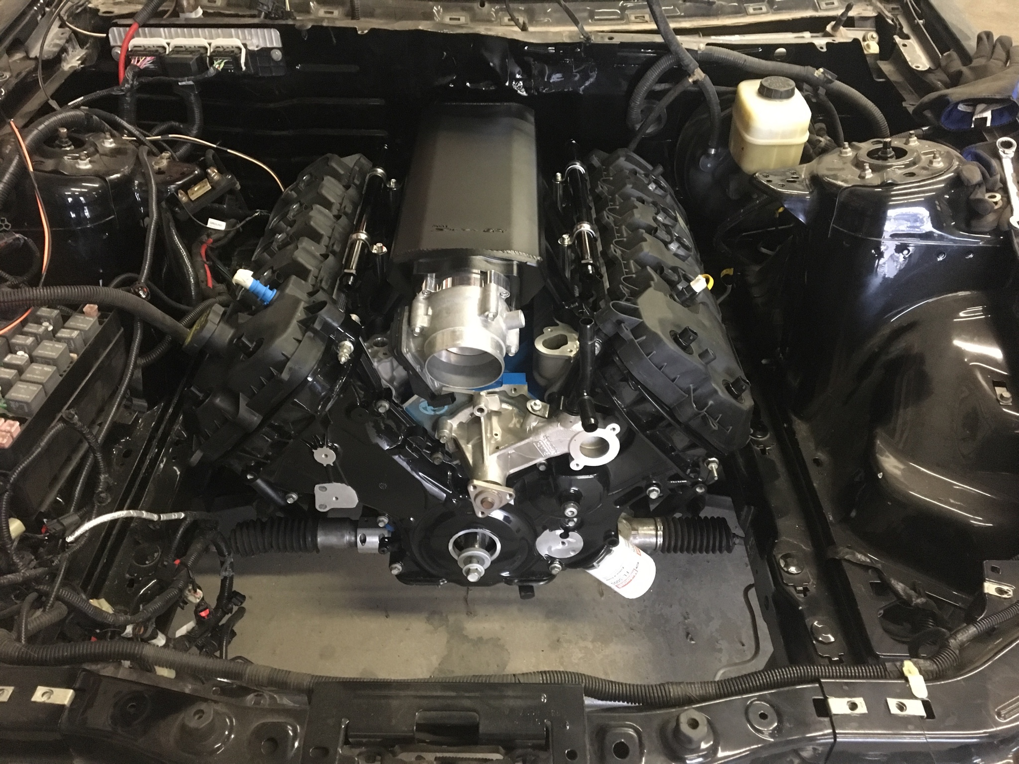

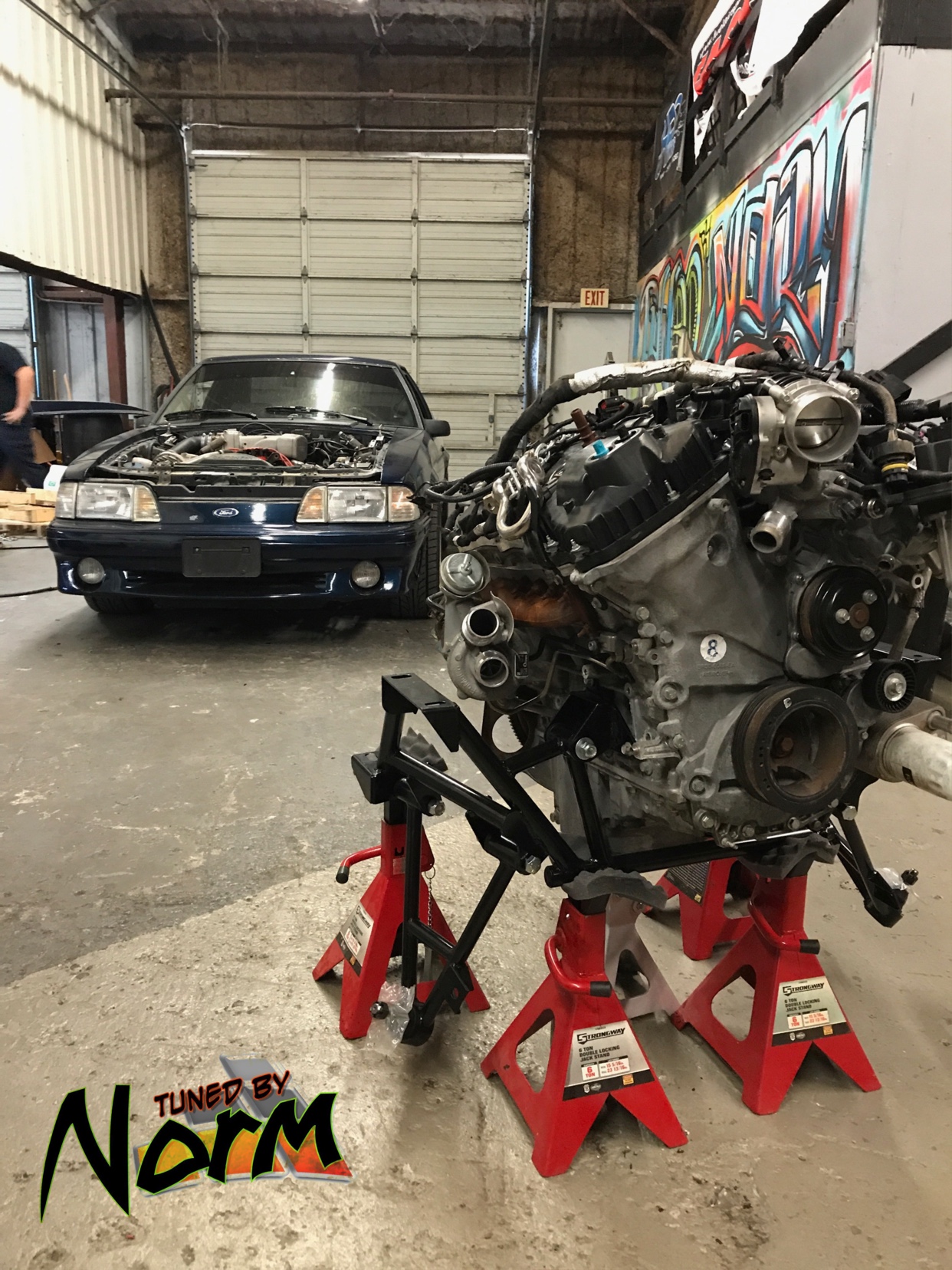

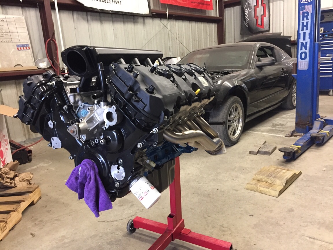

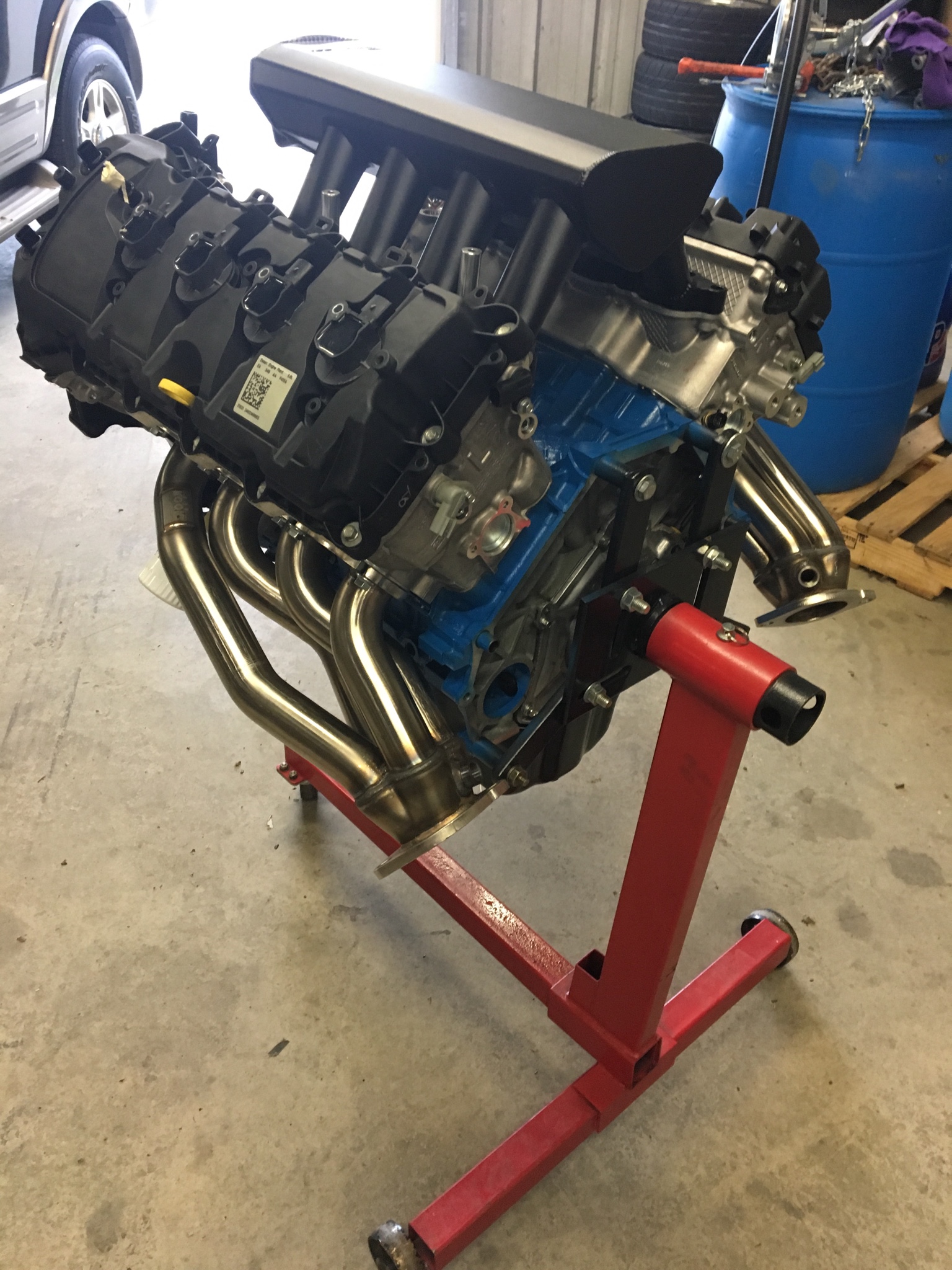

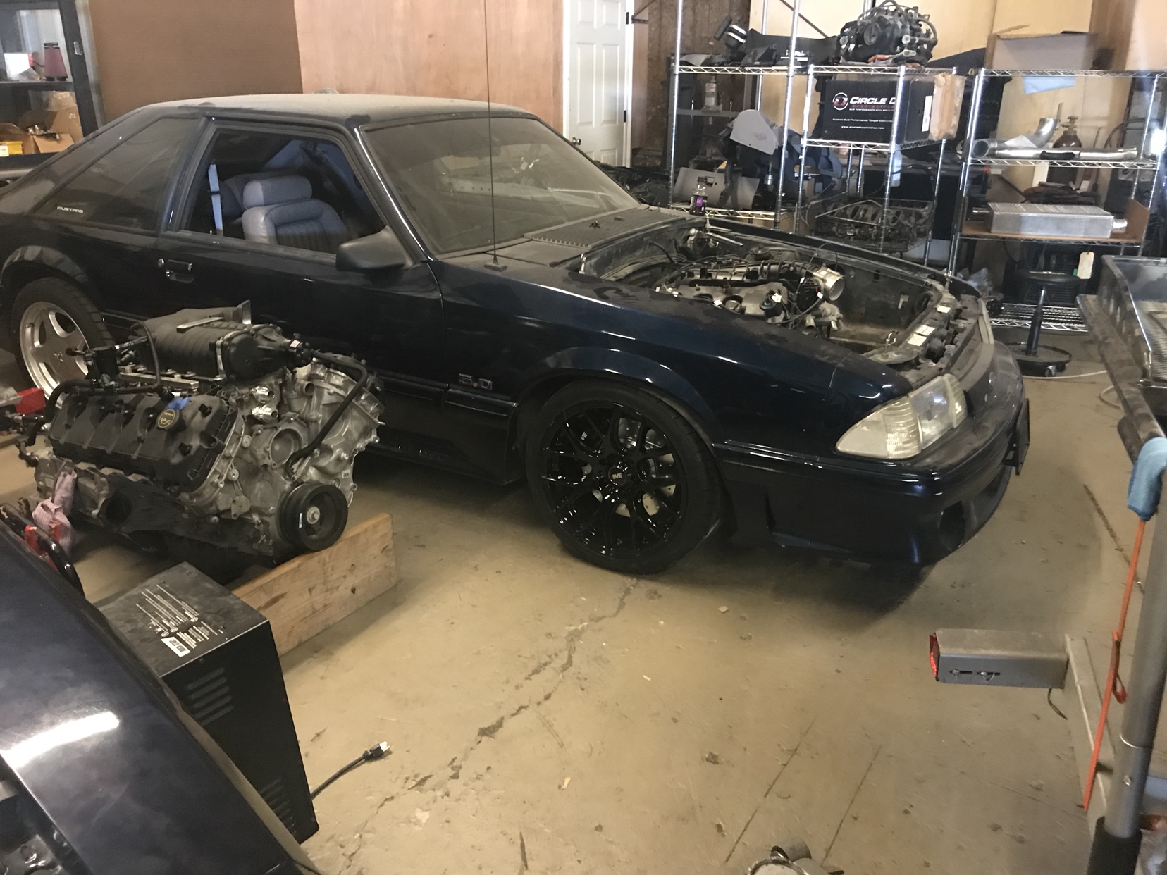

    Made a little more headway. Work has been crazy for a while. Also splitting time on a Foxbody.
    [​IMG][​IMG][​IMG][​IMG]

    Looks good! Why are you waiting to add some boost? That would actually help it seat the rings faster and better.
  12. 05mustang_TT_charged
    05mustang_TT_charged Because Race Car!!
    Posts:
    2,352
    Likes Received:
    Joined:
    Nov 2, 2007
    Location:
    LSU Country
    Going with builders recommendation.

    Awesome build! Good shooting on the pictures too, I love seeing all the details. Question- did you paint the block or do they come blue like that?
    Rm
  14. 05mustang_TT_charged
    Posts:
    2,352
    Likes Received:
    Joined:
    Nov 2, 2007
    Location:
    LSU Country
    Engine builder painted it. He has a coloring system of the level of block it is. Blue for sleeved, red for supports, and I forgot other colors.

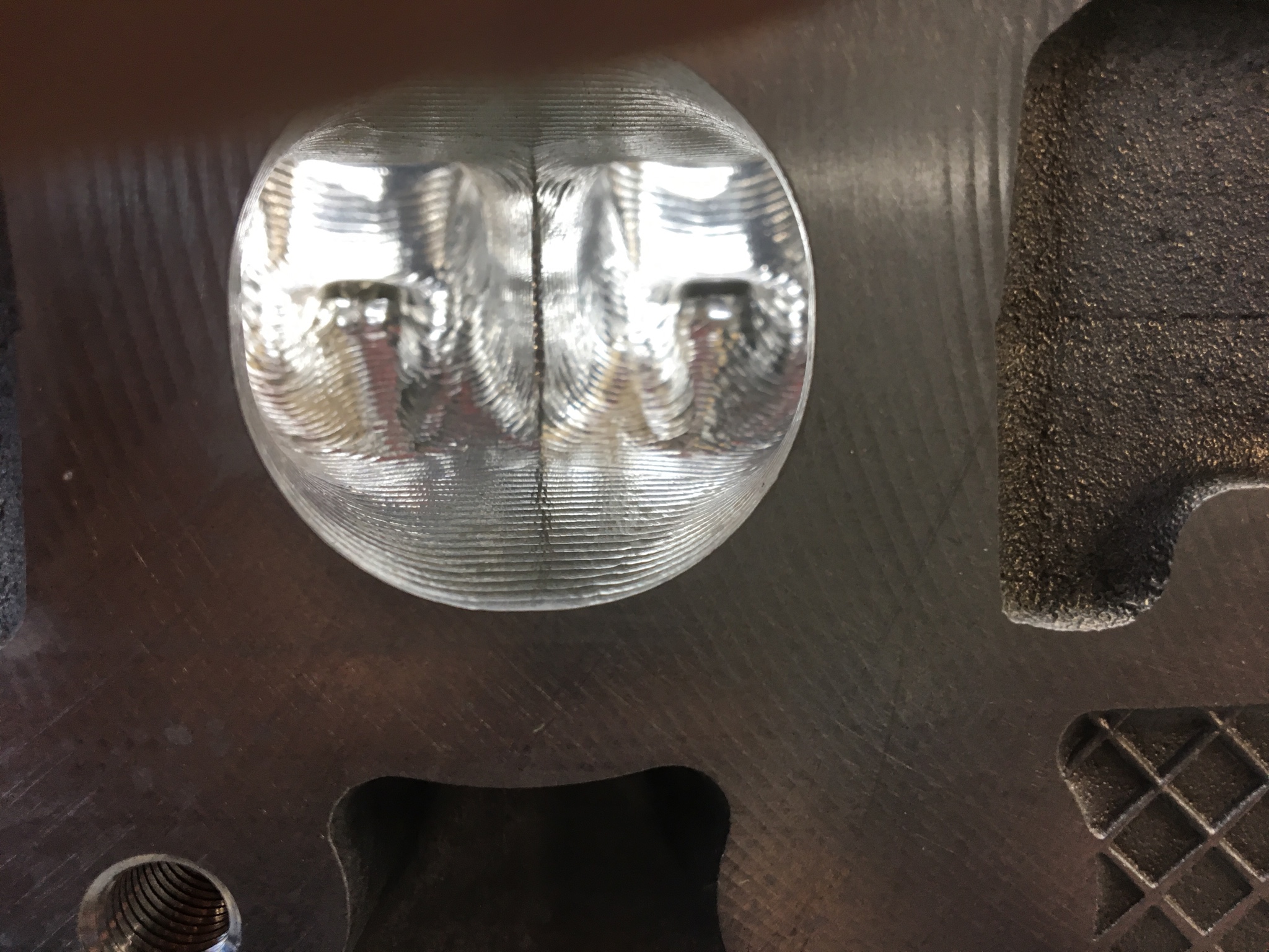

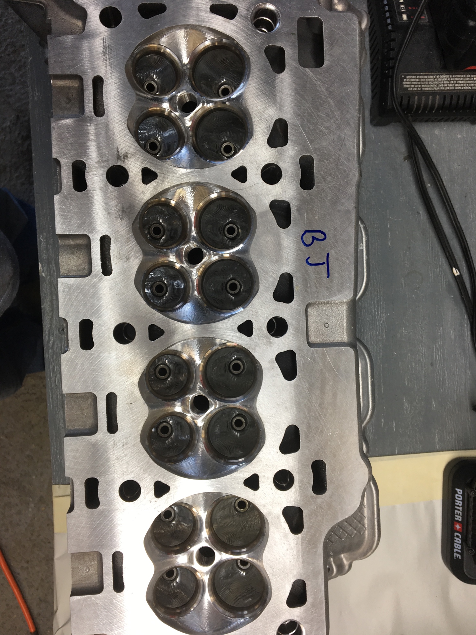

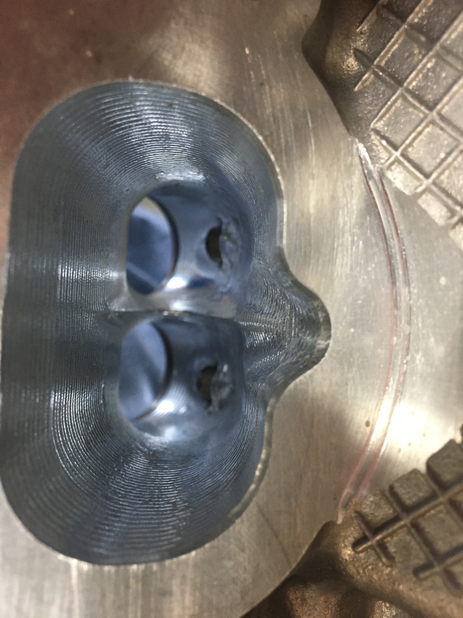

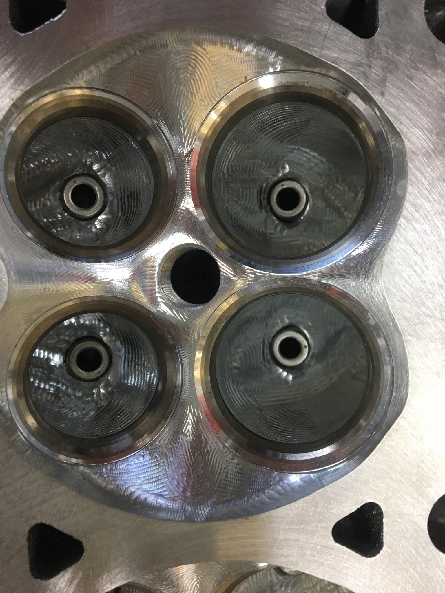

    Here are some pictures of the Livernois race head porting. [​IMG][​IMG][​IMG][​IMG]

    Wow, that is sexual.

  17. stv_huff
    stv_huff Stock
    Posts:
    123
    Likes Received:
    Joined:
    Sep 24, 2017
    Location:
    TX
    I did not expect this thread to end so abruptly...
    That porting is insane. Absolutely beautiful work.
