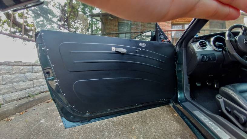

  3. slackinoff
    slackinoff Senior Member
    Posts:
    795
    Likes Received:
    Joined:
    Feb 14, 2016
    Location:
    East Texas
    Looks better in person[​IMG][​IMG]

  7. stv_huff
    stv_huff Stock
    Posts:
    123
    Likes Received:
    Joined:
    Sep 24, 2017
    Location:
    TX
    Those doors are rad.
  8. slackinoff
    Posts:
    795
    Likes Received:
    Joined:
    Feb 14, 2016
    Location:
    East Texas
    Thanks! I have gotten a bunch of compliments from people in person. It's usually the last thing people notice but I also really like them too. It's cool how much more legroom they give too.
    Rm
    Sent from my LG-H910 using Tapatalk
