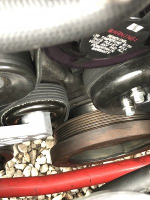

Dec 17, 2017 #1 Big Red Junior Member Joined Mar 19, 2015 Posts 13 Reaction score 0 Location Lake of the Ozarks, Missouri What’s up everyone, so I threw a belt today on my 2005 Saleen SC and from what it’s looking, it seems the harmonic balancer is bad. The crank pulley doesn’t line up with any other pulley. Anyone else have this experience?

Dec 17, 2017 #2 groundpounder forum member Joined Aug 9, 2011 Posts 145 Reaction score 7 Looks like just a stock OEM balancer. Appears the pulley has broken from the hub. Good time to upgrade to an ATI or Innovators West.

Dec 19, 2017 #3 eighty6gt forum member Joined May 9, 2011 Posts 4,299 Reaction score 405 Yikes, this is why I bought a super damper. You're driving the blower through the elastomer - and yours did not hold up. Hot tip: look on ebay for your part - ATI sells them direct with unnoticeable cosmetic blemishes for less than 1/2 price

Dec 31, 2017 #4 M msvela448 forum member Joined Jun 8, 2017 Posts 444 Reaction score 176 Definitely buy the ATI unit and a new ARP bolt and washer. Sent from my A0001 using Tapatalk
