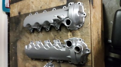

I got a hold of a motor and lots of go fast parts. Much more to come on that. For now, check out the sweet powder coat work from Final Touch powder coating here in town. I got the color done to match the factory strut tower brace.

Looks great! How did the powder coating guy clean the valve covers? Lots of stories around here of sandblasting material getting trapped under the baffles and ruining motors.
That's terrible.
I know they use blasting primarily.

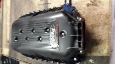

These are the majority of the go fast parts that I have acquired over the past few months. All acquired heavily discounted via facebook, racingjunk, and craigslist.
$40 SR Under drive pulleys
$400 Ford Racing Intake manifold
$500 Kooks longtube headers (new in the box
$0 Pypes off road x pipe
$190 BBK throttle body
$200 SCT X3 Tuner (new in the package)
Things are really looking great for this project!

Forget the underdrive pulleys and drop a TVS on there. Then you can buy all kinds of supporting mods.
After reading your post I went out there and inspected them and they didn't look too bad. Put them in the sink out there and rinsed the baffles, big clumps of sand came rolling out.
You're a life saver. Good call.

Holy crap.
The PCV valve is integral to the cover and may be labyrinthine. Don't be sure it's all cleaned out.
