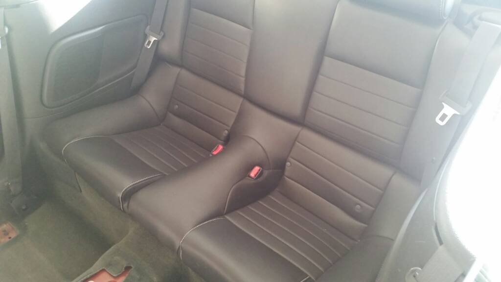

Pieced the rear seating and trim back together, hopefully have no need to pull it apart again.

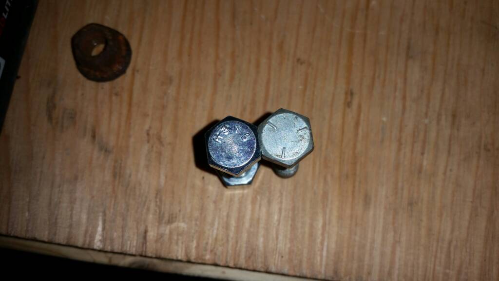

I had to press out a broken stud on the right upper side of the cat flange. No biggie, some PB blaster and a few whacks with the hammer while balancing it against the vice and it came right out.
I have a couple of bolts on hand that'll fit for replacement. One is a grade 5 which I believe is adequate, the other I can't find a reference for the marking. It appears to be marked H315. Comments on the suitability of either and/or what that H315 on the one on the left denotes?

I decided to go with a purpose-built M10 grade 8 bolt with a wider shoulder, and matching shoulder nut to replace the broken stud.
Also ran a die down the other three studs to clean up the threads, and picked up new shoulder nuts from the dealership for those as well. 40 cents apiece, why not.
