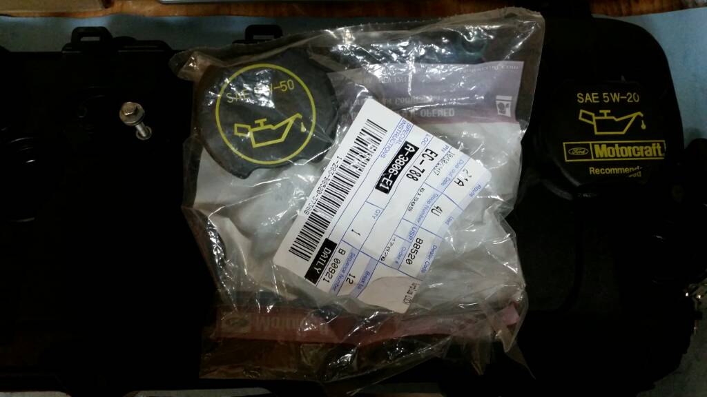

On a semi-related note, had them order a new oil cap too (that got cracked by the PCM as well). They ordered, unfortunately, the cap for a boss. I'd keep it and move up to 50 weight for the higher temp capability, but the pressure would be significantly higher. I'm worried that'll mess up the VVT pressures, so I'll just have them order the correct cap and stick with the 20 weight.

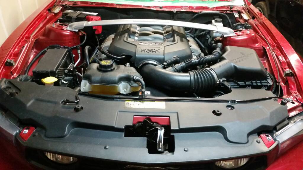

New VCT is installed, engine components and covers are all back on, strut tower brace is torqued down. That does it for engine bay rebuild.
The whine is still there, so after the exhaust is complete I'll take another listen with the belts off (will be easier to hear with it all back together).

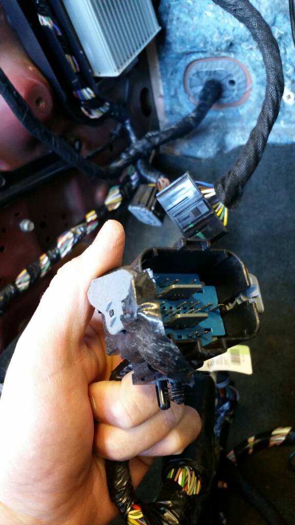

...the body harness connectors were all the same across years, except for one. In the 2011 there's an 18 (used) pin that sits up behind the dash cluster area that joins to the engine bay/fuse box harness - well, in addition to the aforementioned mirror/overhead/shifter differences. In later builds (presumably 13/14) this connector is replaced with two separate connectors that live down in the left footwell, so I have a mismatch.
This means I get to swap out the engine bay harness/fuse box too! Yippee. I could just cut and splice the 2014 connectors (already confirmed pins are all replicated equally other than the second 2011 amp, which I don't need - 2014 combined them into one), but I don't want to ruin the 2014 harness until I'm sure I don't need it. If I want to go with the HIDs (along with anything else I'm not thinking of) eventually, then I'd rather it was unmolested.
So current plan is to swap in the 2014 body harness AND bay harness, HIDs, and probably the SJB as well. Then test and see if everything works. I figure I'll have to tell the PCM that it's got a new SJB, and probably eventually flash the PCM to 2014 strategy.
If that doesn't work out, then I'll put all the 2011 wiring back in and just hack the outstanding necessities together.
What a timeframe setback! The pursuit of stock-ish wiring perfection plagues me.

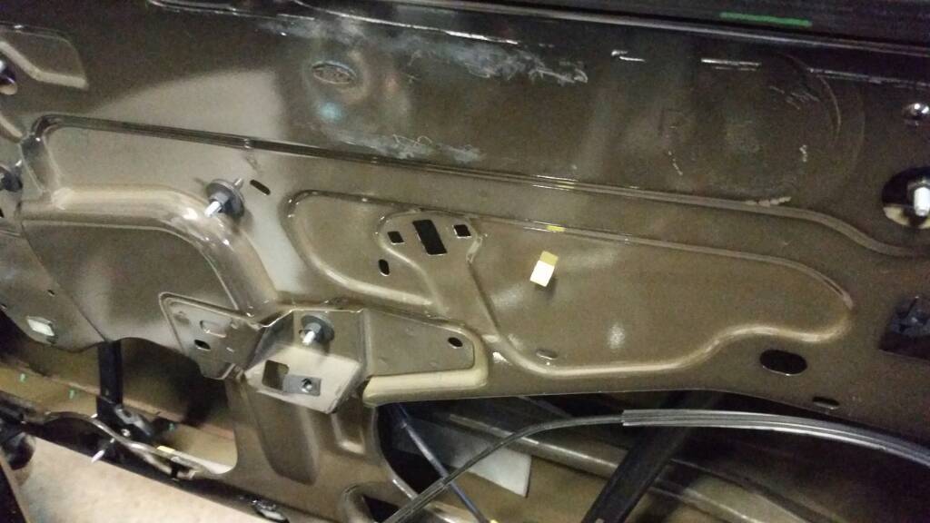

Swapped the driver door (good 2014), and the passenger door (crunched 2014) wiring. I had to dremel the crash sensor mount holes into the passenger door as they weren't already formed in the 2011 doors.

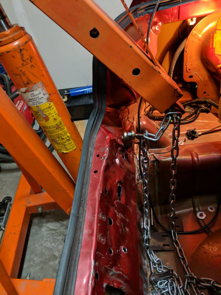

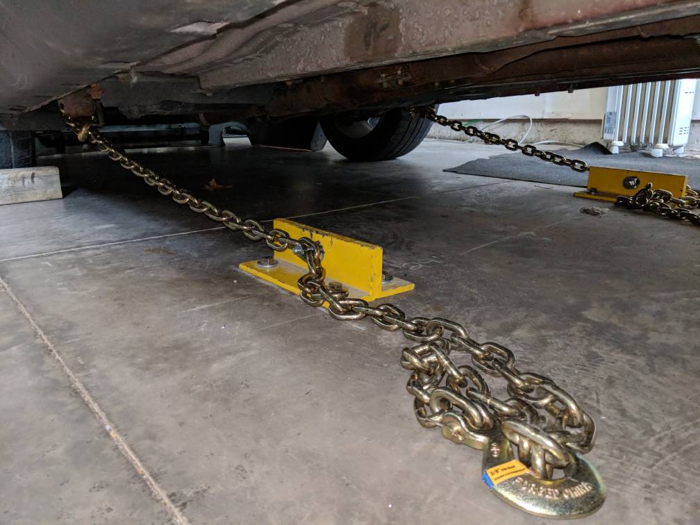

Rear bumper/frame pull - trying to find equipment to do it myself. Either need an L bar setup (like a versa puller) or install plates/pots in my garage floor to chain to and use a porta power unit. Still watching the classifieds for the L bar before i start drilling holes. May pop up to the local autobody place to get an estimate, just in case it's cheaper then i think it will be to have a pro do it.

I have a friend who does industrial electrical work. He was able to get me concrete floor shots cheap (bulk) and borrow some of the plates they use to anchor wire pulls. I have another friend who races mod lights who had a porta power kit that he lent to me. Couple that with some chains and my engine hoist and I was off to the races with the frame tweak, bumper/mounts pull, and trunk pan work.

After maybe eight hours of pushing and pulling (keep in mind that for each operation I have to reposition the car, because my anchor points are fixed) I got everything very close. Not concourse level close, but daily driver close. Tacked a few spots, filled the pan pull holes i drilled, re-filled the rest with seam sealer (ie pan to back panel, as done at the factory), and fitted the 2014 bumper and bumper cover. Success.
