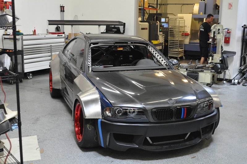

For BMWs like this E92 M3 above you have as few as 3 gearing options, and they are all $1200+ for the ring and pinion alone. For the EVO X next to it the choices are even worse. But for the Ford 8.8" 28-31 spline axles that come in the S197 chassis you can get proper Ford Racing gearing options in dozens of ratios for under $200 in parts. Its about 2.5 hours of work by a properly qualified shop, so its relatively CHEAP compared to many other cars.
