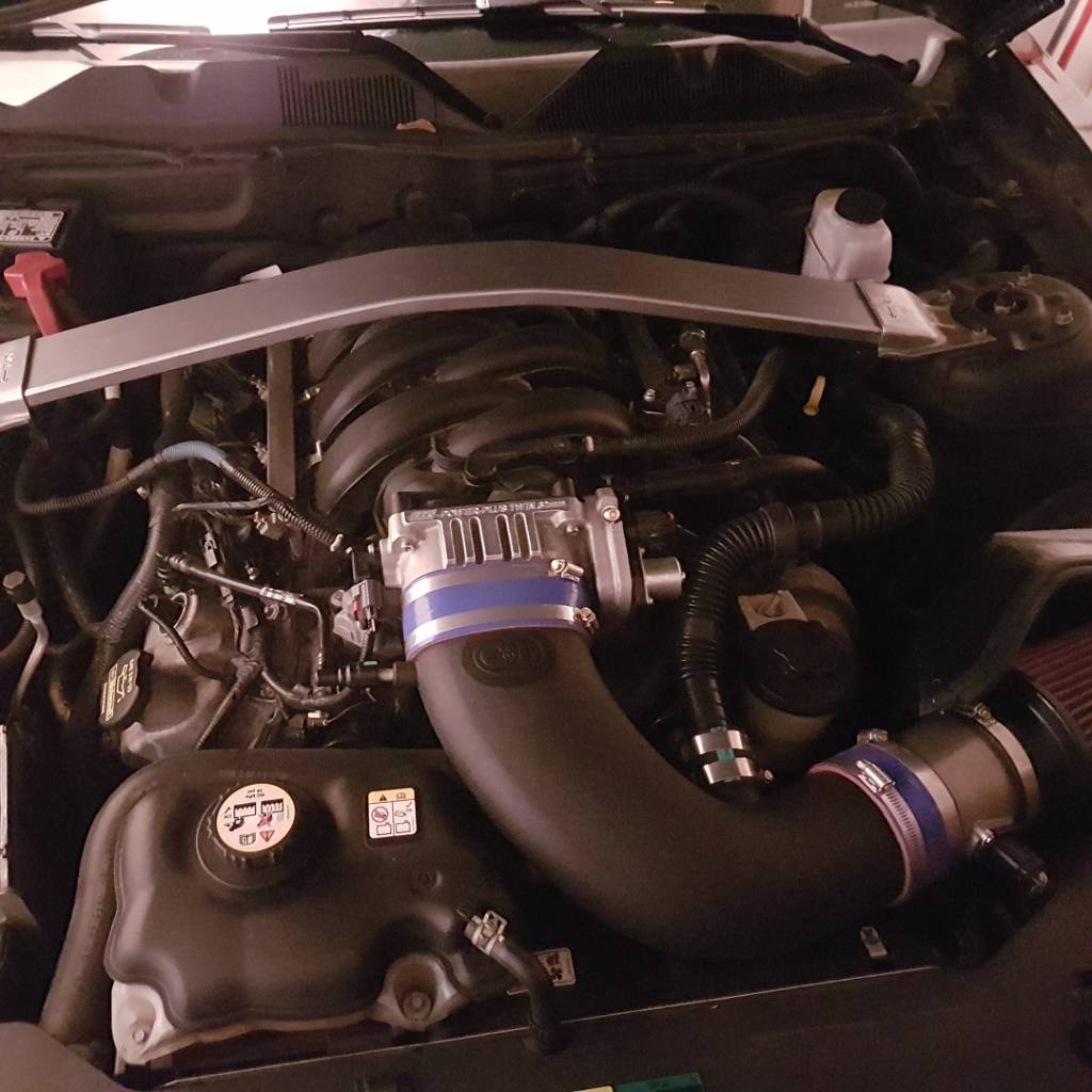

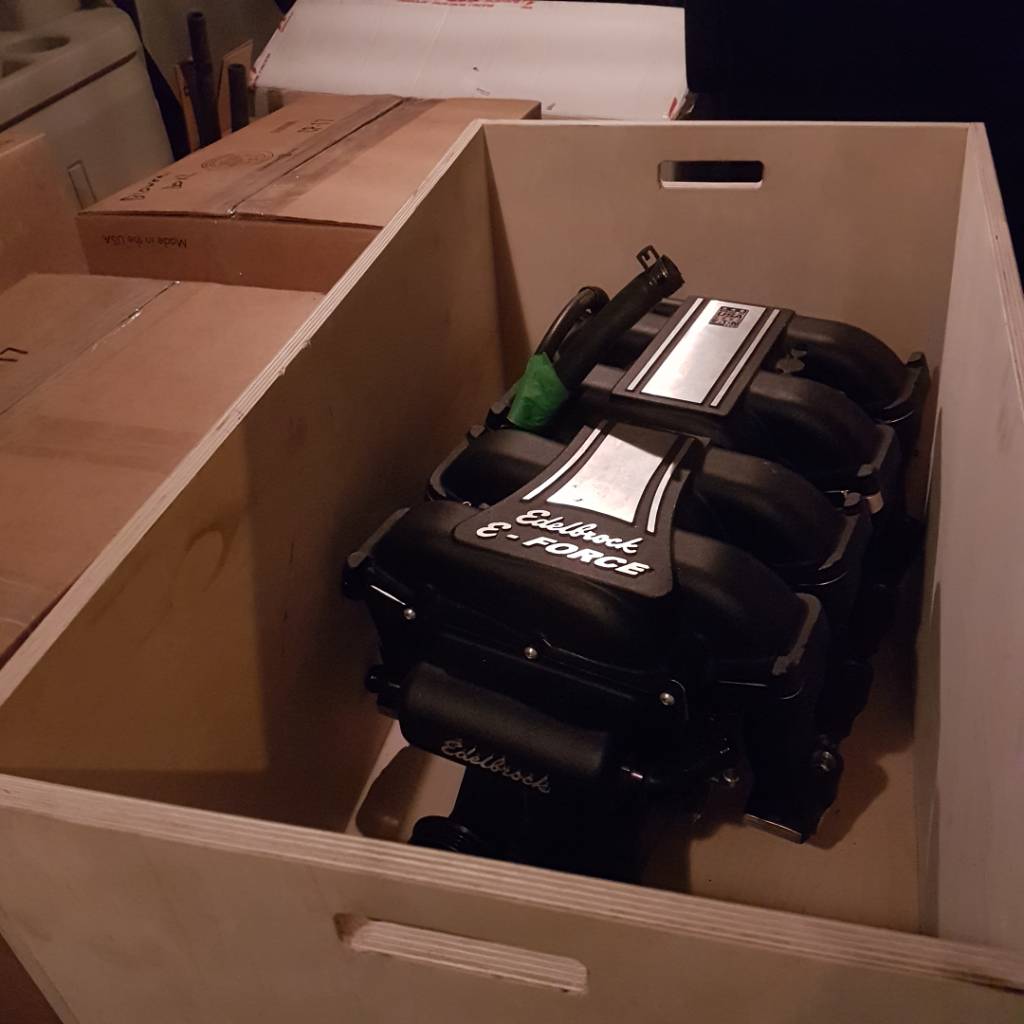

Johnstone
Oct 3, 2017
112
12
The transformation begins...very excited.
Sent from my SM-G930W8 using Tapatalk

What heat exchanger set up are you going to run?
Im not sure yet.. but i have bigger problems.. aparently this model i bought is for a 2009 mustang and NOT 2010!
Let the fun begin!
