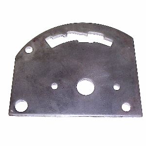

So, is it the plate for the 4r or do they make one specifically for the 6r?

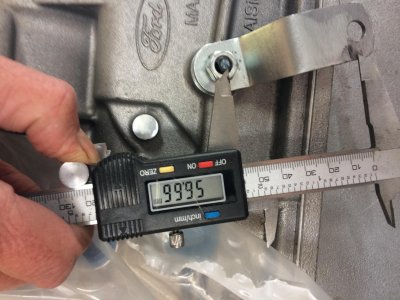

I guess you me the shifter gate plate as photo included. The shifters come with 2 gates 1 for 3 speed and 1 for 4 speed autos and are really designed for older type auto trans 350-400 turbos, C4-C6 etc. The trick is the length of the shift arm on the transmission see picture. The measurement on the caliper might be a little short but you just need to play with it a little bit until it hits all the detents on the transmission correctly. I also had to fabricate the bracket for mounting the cable to the transmission sorry I don't have a pic of that I usedtwo of the brackets included to make one.
