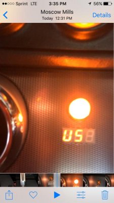

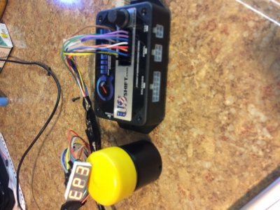

I went ahead and wired up a remote display went to an electronics shop and got a bunch of jumper wires put them together an walah. It was a bit tedious but I got it done doing the same thing with a shfift light plan to mount both between the center AC vents

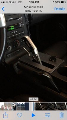

Got the shift light and display installed finally still need to make a bezel for the display hopefully can get it done soon
