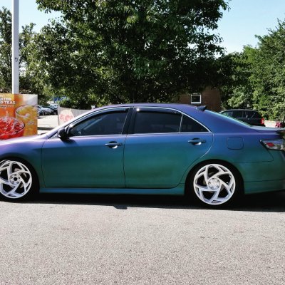

I can't get past this, smh
Why SYH? I got it as a deal from someone. Didn't look too bad at all.
Thank you BTW, to those who helped out. A lot of good information in this post.

Because a 235 section on a 10” rim is silly
JTDSR
Oct 14, 2017
Looked good enough. But then again, the purpose of this thread was not to childishly ridicule the previous wheel/tire selection, but to provide information on a purchase for my Mustang. I believe that was done sufficiently. Thank you again to those who supplied the information.

LOL, you think you were ridiculed..... this is a very matter of fact board, people don't pull punches.
as far as looks, hard to see how those tires looked in your picture, so I'll remain reserved on judgement.
the more typical debate would be can I fit a 315-335 mm tire on a 10" rim.

It looked fine in person. I had to run 235's, because 245's would have rubbed the coilovers.
I laughed at the idiocy of ridiculing my previous setup, as this post was looking for advice on my Mustang. But hey, whatever floats your boat. ;)

Too late now to lose your Camry tire size information, but you'd have been a lot better off if you hadn't included it. Let's just say that the extreme-stretched look - where the wheels are an inch or more wider than the max end of Tire & Rim Association guidelines (what the tire mfrs are really referencing in their tables of dimensions) - hasn't made it over to the ponycar world from the import side. If you ever see a post where I refer to this as "Euro-stretch" . . . you'll know what I meant and it usually isn't intended as a compliment.
On the U.S. domestic side, you're way more likely to see discussions on the other extreme (wheels narrower than the T&RA minimum guideline). But I guess you haven't been here long enough to pick up on that.
If your R8s5's are undamaged and capable of being made to run smoothly, you're probably going to want something like 255/40-19 and 285/35-19 if you want to run staggered. Or 275/35-19's, possibly 285/35-19's all around if you want a 'square' setup. That's off the top of my head because it's an easy conversion from the GT500-size tires for both diameter and load capacity @ normal inflation pressures.
FWIW, I'll run tires on max-width wheels without thinking twice about it. This is a mild stretch relative to running the same tires on their "measuring width" wheels, enough to be visible. And that's more of a stretch than you're likely to see on any of the ponycar (Mustang, Camaro, and Challenger) forums. So even though I'm closer to understanding your 235/45's on 10's, 1" over max combinations like your Camry's are still about an inch too extreme even for me.
