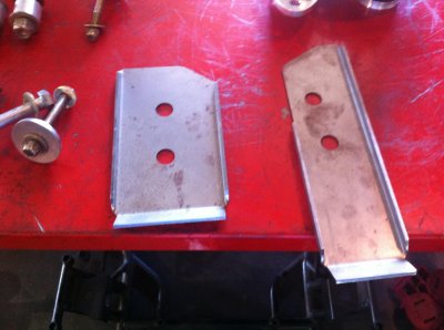

*The only other issues I have seen with customers using our K-Members are the rear mounts caving in the floorpans. That area of the stock chassis is not very strong, so this is something that I think is more common than most know.
Specifically for this reason, Shelby offered plates that weld to the floorpans, between them and the rear k-member mounts. The plates also weld to the sfc's. They seem to be keeping the floorpans straight so far. IMO, with the chassis brace, the BMR k-member seems to add stiffness up front (i.e. it takes a set quicker).

Hell I could slap a set of those together at work. Seems pretty simple, cut it out and grab a break to bend the edges over.
06Coyote
Oct 26, 2016
9
Can you cut me a set too. Let me know how much you need me to send you.
