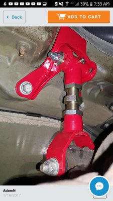

Hello. Thx for response. Yes. 1,2,3. If u look at the attached photo which I pulled off the internet (only difference is my upper control arm is NOT adjustable as the one in the photo), the hole the bolt is running through would be the correct hole to use...lets call it position "1" of 3 possible, where position "1" would be the closest to the "base" of the rear upper control arm frame mount. At least that is what I was told by vendor.
Again, just hoping the "2nd" position (so the middle hole out of 3) my mechanic ran the bolt through would not cause premature wear and tear. I could just have it re-inserted but the labor takes some time.
Idk, one inch lowered car probably won't make make too much difference correct?

None of the holes will cause premature wear and tear, it will just have an effect on the way the suspension reacts.
I think my BMR mount is an older one as I only have 2 holes, one that was in the same position as stock and one that is lower than stock. I use the top hole (stock location) on mine.

Most of the research I've done shows the stock location is the best location unless you're having some sort of extreme issue. A lot of upper control arm mounts don't have any adjustment for that reason.

BMR and UPR have both told me the stock location is best for most applications lowered or not, which is why the UPR mount only has the stock location
I would have him put the UCA in the mount hole where you told/paid him to.

That might be the right logic for setting the LCAs in 3-hole relo brackets, but I don't think it is for the UCA in its chassis bracket.
If hole #1 is located in exactly the stock location, lowering the car an inch isn't going to cost you more than a couple percent antisquat out of about 30%. What that means in driving is that while launch bite may suffer slightly you'll never notice this once you get rolling. Hole #2 will give a stronger launch, if that's what you're actively looking for. But there might be some payback in terms of ride quality over bumps under much throttle or much braking.
Hole #1 is probably still better for normal driving, autocross, and road course driving, hole #2 for a street-oriented street/strip setup.
Your call.

For the UCA mount, ( on the 05-10 UCA's and mating UCA mount), mine was a 2 hole affair. Bottom hole on UCA mount used for stock ride height. Top hole used if car lowered.

Thx for response guys. So i got a response from BMR. Since I dont have LCA mounts, BMR was thinking position 2 or 3. Based on what i am reading above, and my desire for stronger launches, I am leaning towards leaving it in position two (middle hole). Maybe my mechanic surmised this...idk. I havent yet had a chance to get it back on the track to test it and really determine how it feels, but some hard street driving so far has yielded it feels good. As our friend from "Cheers" (haha Norm Peterson) suggested, the ride over bumps has been magnified. Oddly, I kind of like that "feel" every bump feel. So far, I haven't hit any bumps that sent me flying, knock on wood. It appears any position will work and as others indicated choice is based on individual preference. And if I am reading all input correctly none will prematurely wear or tear on car. Which was my big concern since I am keeping my Stang for life...haha.
