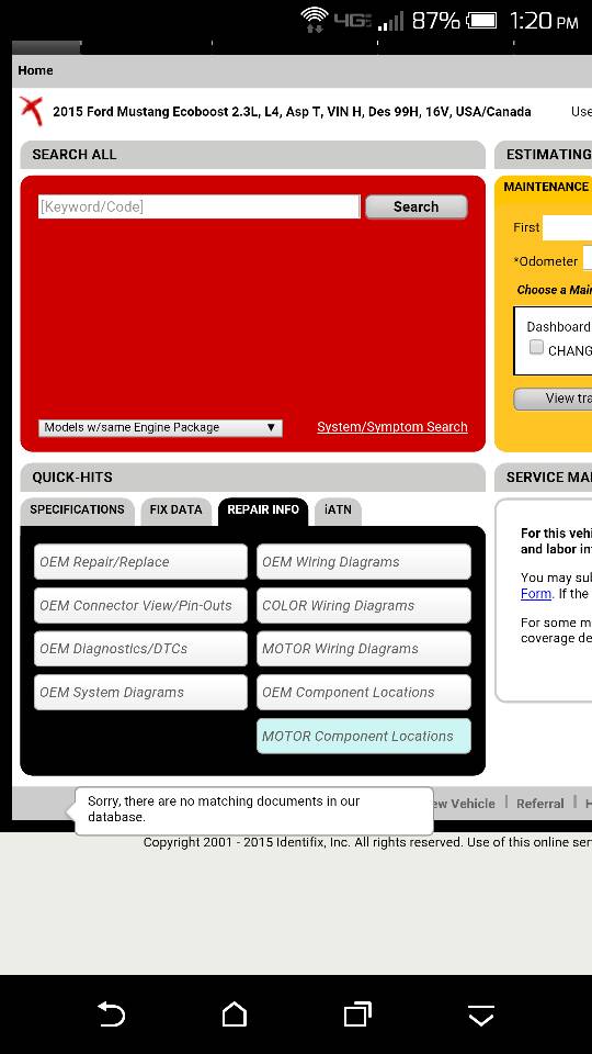

I don't know specifically on the ecoboost engine. But through work I have access to a website that gives us repair instructions for pretty much every car. We use it to work on our non BMW used cars we take in on trade. I'll see if I can find something with a diagram on the ecoboosts PCV system. It's a great program I'm sure it will have what you need to trace the system. I use it all the time for my car.

Excuse me while I put my foot in my mouth. Looks like they don't have shit in the database for the ecoboost yet...see how everything is grayed out? I get the message that no data is available yet. I'm sure if I had the motor in front of me I could figure it out...let me try a good old Google Search and see what I come up with.
What system are you using?
