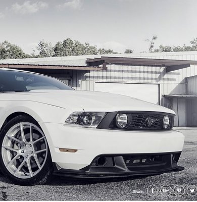

    Looks like the factory option HID head light that cost $525 when I ordered my 2011 v6 :) 2015-06-06 01.28.11.jpg
