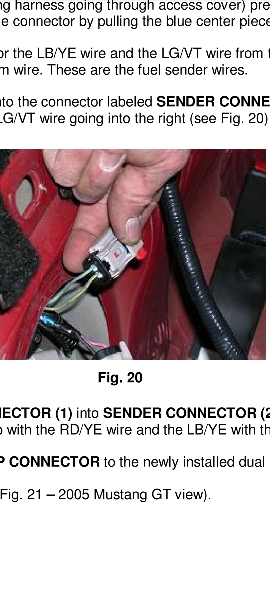

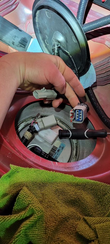

I bought a GT500 fuel pump kit from another member at least 3 years ago. The kit was new take of from JDM. Everything seems to be in the kit, well boxed and bagged.
I have an 05 GT
Problem is with the wiring from my car to the gt500 wiring. I have the plug pulled apart as they state to do. Says to plug sender wiring into sender connector. They're isn't one. Seems like a male connector would have come with the kit, but I don't have one. I am guessing because the instructions don't have a list of included small parts. Wiring harness, pump, and module is all that's listed.
Can anyone confirm that I am missing something?

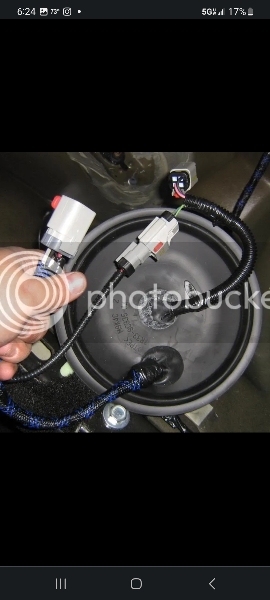

First picture is what I have. Second is the connector they say I should be connecting to? Third picture is a picture of what I found of someone else's install, his was an 07. BTW my existing sender wires are pulled tight, maybe stuck. It must definitely will not come out any further.

What is missing is a jumper harness, which was included later in gt500 fuel pump upgrade. I talked to FRPP yesterday. All he would say is it's a jumper harness and gave me the part number CM-14407FR463A for the jumper. From everything I have found online, it was a two pin male connector at one time. It would leave you with existing 4 pin left unplugged with a new 2 pin male plugged to main harness. If I could get my hands on a 4 pin male that matches my existing GT plug, I would just rewire the tail of the duel pump harness. The jumper harness that comes in the kit now does just that, but with four plugs. Plug and play if you will. I found a picture online of someone else's install that showed it. My kit is an older kit that's been sitting for a long while. The install instructions are outdated starting at step 29 -32, even the fig. 20 isn't correct.
I was planning to update this thread for future reference.
I agree it wasn't as straightforward as they made it, but it wasn't bad. There isn't even a parts list supplied in the box, so I couldn't even verify if I was missing something. JeremyH helped me over the weekend by confirming I was missing a part.
