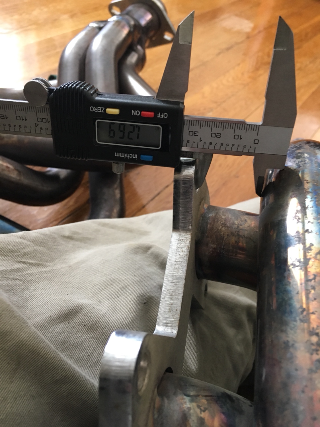

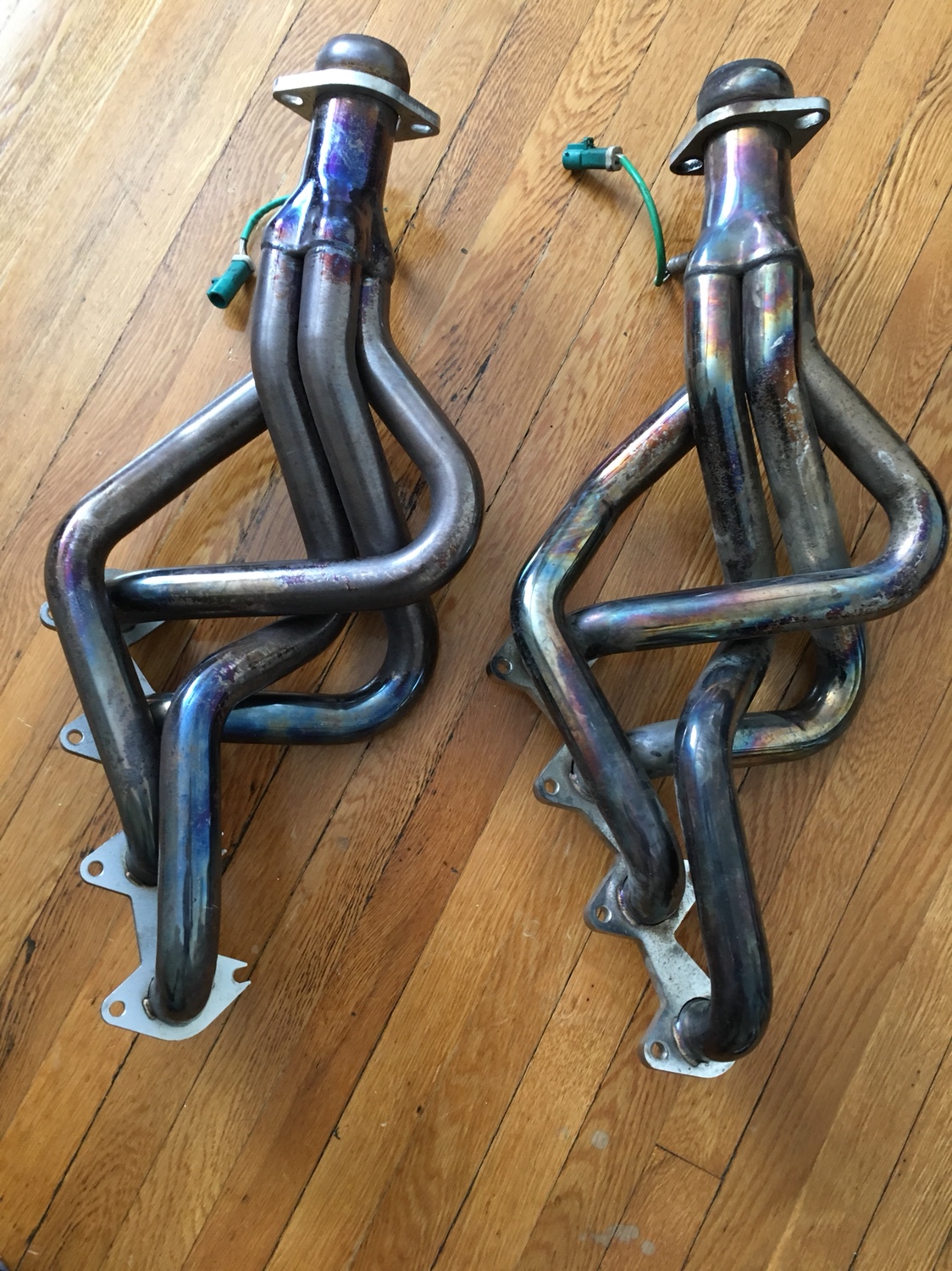

The steering shaft rubbing was bothering me and it actually got worse over time where I could start feeling the vibrations through the steering wheel. Guess even though I shift the engine over, over time it settled back? I dunno.
I really didn't want to remove the header to ding it and actually tried while it was still on the car and didn't have enough leverage.
I was lucky enough to find a used left side header only (ebay to the rescue again!) and took a chance as they seemed like actual Pypes and not the copy of a copy.
Also it being used I did not see any markings where it would rub so I went ahead and installed the left side only today.
It was hard to tell the difference at first until I decided to measure the offending primary and there was about 1/2" difference in clearance where the tube bends away from the flanges. Other than that they were identical to the point were if I wasn't paying attention I would of tried to reinstall the wrong ones again, haha!
I will post some pics up soon of what I'm on about.

eBay Left vs Pypes Right:
Pypes tube from flange distance:
Ebay tube from flangr distance:
Just measuring the difference
