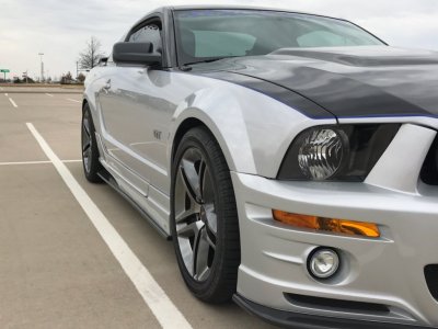

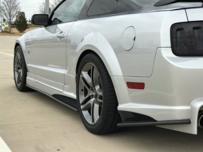

Side note, I run 285/35/19's front and back (square setup) on two different '07's, both with '10-'12 OEM split spoke Shebly GT500 wheels. I am currently running Goodyear Eagle F1's (OEM) on both cars.

I like the idea of the "square" setup - those rims are 9.5" wide, correct?
