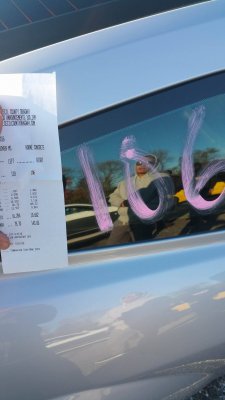

Update: 11-15-16
Went to the Cecil Dragway on Saturday. I had 5 passes and only 1 yielded a good time. I brokeup on first, second, and partially in third gear. I still managed a 10.6@ 143 with a 1.63 60'. After looking at the logs, manuel said it was misfiring and he adjusted the tune to give me some more timing. I need to put new plugs in for the misfire issue. Either way, not having a great pass and hitting 143 was nice. The 1.63 shows me that I should be able to get that down with a few adjustments.

nice work jason! still stock suspension? crazy...
I'll keep an eye out for your car when I come up to Capitol!
