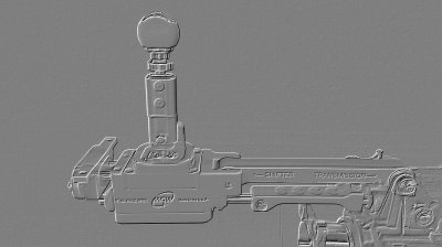

Hey guys,
We will be releasing the new RACE SPEC MT-82 shifter next week....
it is a complete replacement of the factory unit...EVERYTHING from the tail housing back is new.
- the support arm.
- the linkage arm.
- the pivot cup.
This shifter design is essentially a "top loader" concept. THere are no swivel or universal joints in the linkage rod like oem. It is straight back into a machined lower box with stainless ground linkage rod and stainless pivot cup. The side swing arm oem design is dumped for a 1.500 thick aluminum centerbeam that basically "welds" the shifter box to the transmission. The linkage arm also works as additional support for the shifter since it does not pivot.
The rear support bushing is ONLY designed for NVH dissipation. We have actually run the shifter on track with the rear bracket removed and it shifts the same. There is good science in attaching the rear pins into the rubber core for vibration dampening which is why MGW shifters are notably quieter and smoother than anything on the market.
Come like us on Facebook for a first look at the shifter design next week... I'll follow up with details here too of course !!

hrmmmmm why is the rear still attached to the body? doesnt that defeat the purpose? I see you say for noise dissipation, the design looks promising, but Ill have to see a real one to understand how it fully works. this will save lots of money over the MGW and Blowfish bracket I was planning on buying

I explained briefly but in detail we tested this shifter extensively to get the maximum performance AND minimum noise and vibration.
We can easily remove the rear bracket and run the car all day long on track.
You need to get it out of your head that it is a support bracket ( ALTHOUGH ADMITTEDLY IT LOOKS THAT WAY LOL )
It is used primarily as an NVH conduit. And it works VERY VERY well.
I'll post a video up next week showing how stout this thing is. We have it mounted onto an MT-82 with the back end just hanging in air and it shifts like a tank!!
