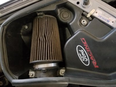

I have tried loosen the clamp, it has a peg that won't allow it to spin and on on other end that won't allow it to come out. After a little research it is a throw away air filter but I still am struggling to get it out. I just don't want to break part of the housing.

That looks like you're going to have to also remove the pipe going form the intake to the filter. You won't have enough room otherwise.

I used to have to loosen the intake tube to get enough wiggle room to maneuver the filter out of my housing. I have since gone to a slightly shorter filter and it can barely squeak out of there but I don't have to loosen up anything else.

No, don't cut anything. Loosen/remove those two bolts on either side of the intake tube by the neck of the air filter. They take either a 10mm or 13mm socket. Then lift the filter up out of the box and twist it off the tube. It's rubber on plastic so it sticks, you need to unstick it to get it off.

I just LOVE the people that say to cut stuff!!!!!! The filter went in without cutting stuff, it will come out without cutting! As skwerl said, two bolts and lift it up to remove.

Most definitely need a replacement & the answer is there (remove two bolts, wiggle loose & pop out). It's just been in there way too long...probably since rolling off factory belt. :D

Once you get it removed, clean the inside of the tube downstream. No doubt, all sorts of crap will have migrated past the dirty filter. I'd clean it all out, end to end, TB included...+ maf sensor etc.
