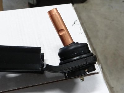

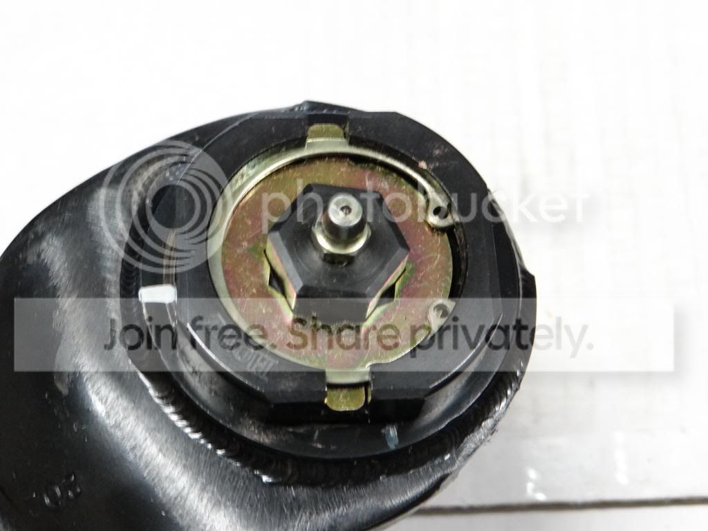

The picture of the copper colored BJ is a FRPP Boss 302S ball joint that comes with the arm from Ford. (Stolen from zquez's thread).
The pic of the silver/Greg ball joint is a Steeds X11 ball joint.
OP, snap a pic of your old and new BJ if you can.

Yes, the Boss 302S arms have Howe racing ball joints in them. They are welded to the arm, and screw in.
