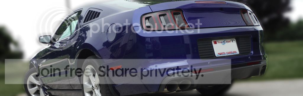

I need a better camera

What tool did you use to soften the border of the car and get the unfocused look like that?

I have Photoshop. I made two layers of the pic, then added a Gaussian blur to the top layer, airbrush erase the car in the top layer (exposing bottom layer in focus) and then flattening both layers together. I was tinkering, it could be better. But new camera regardless. Lol.
