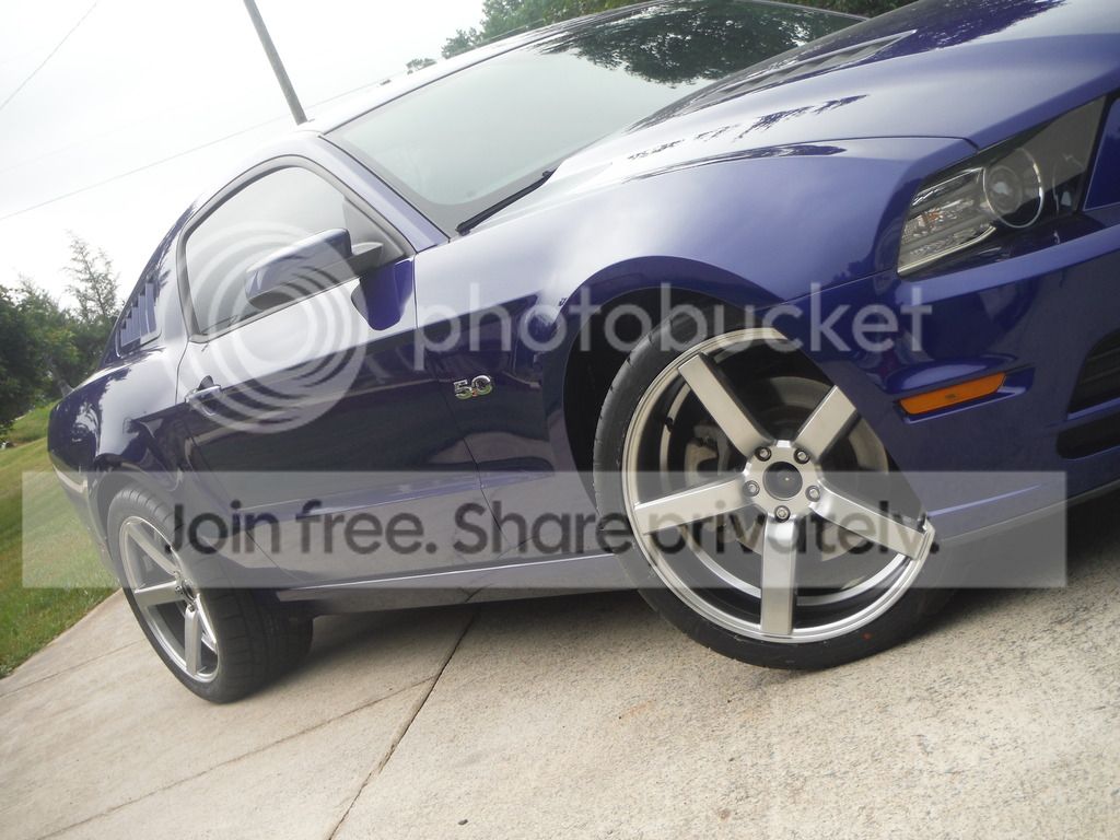

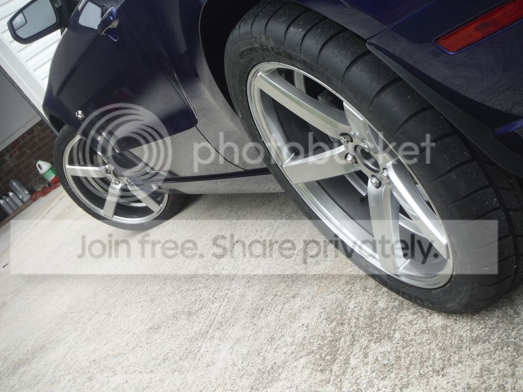

Just got them installed with the tires. Need to find time for pictures. Warning though; this car needs to be lowered badly.
After the install, Ive became worried about when I lower the car with BMR springs. The setup is 305/35/20 on a 20x10 (+40 offset). It pokes some.

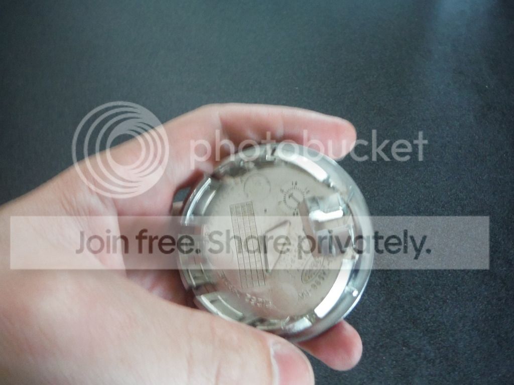

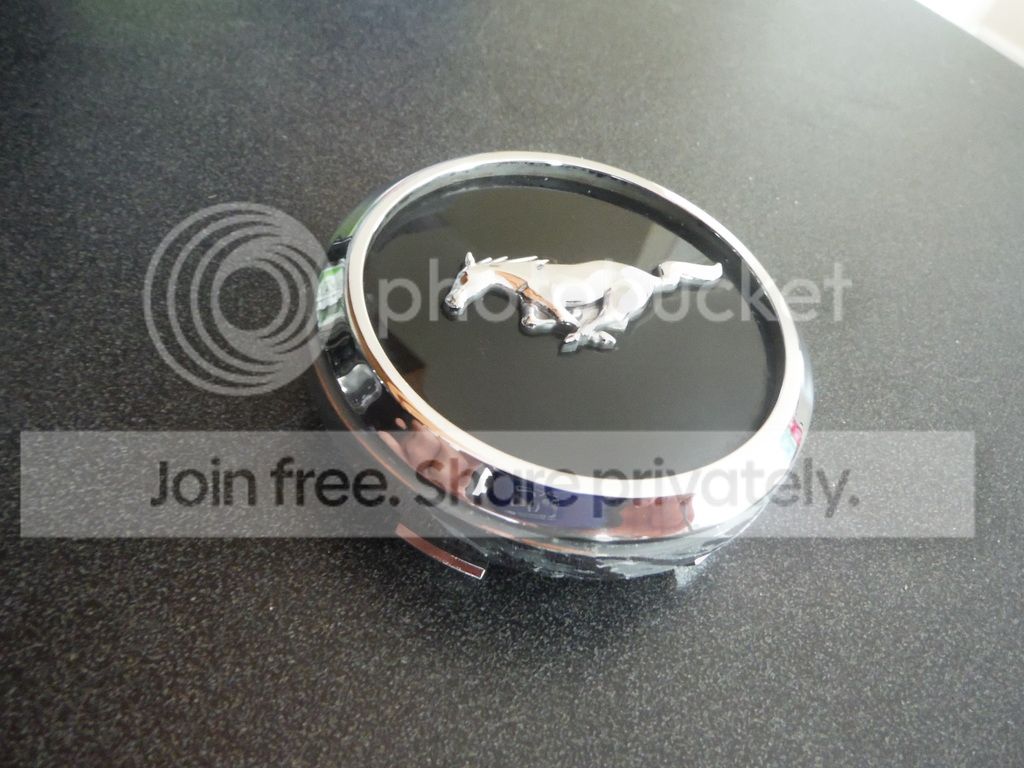

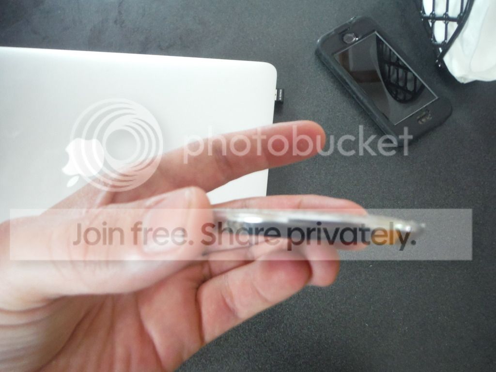

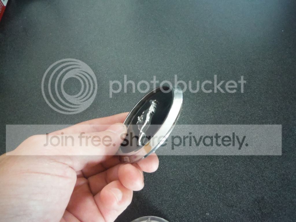

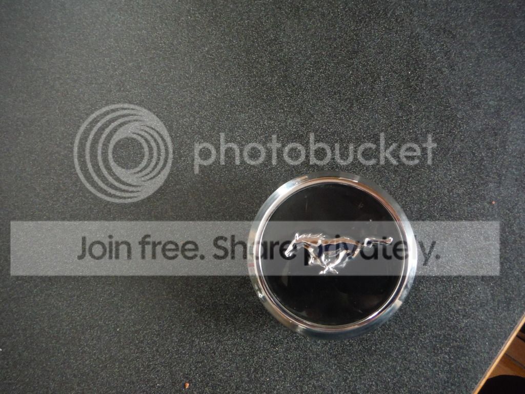

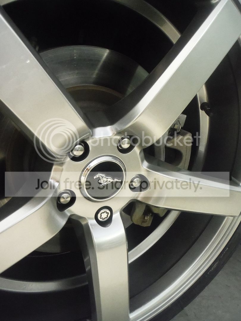

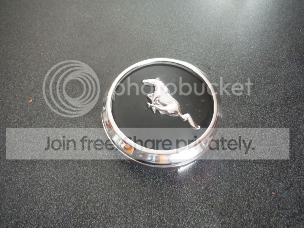

To help take my mind off the worry that I bought too much tire and potential rubbing issues when I lower my car on the BMR spring, I decided to tackle the DIY center cap idea I had.

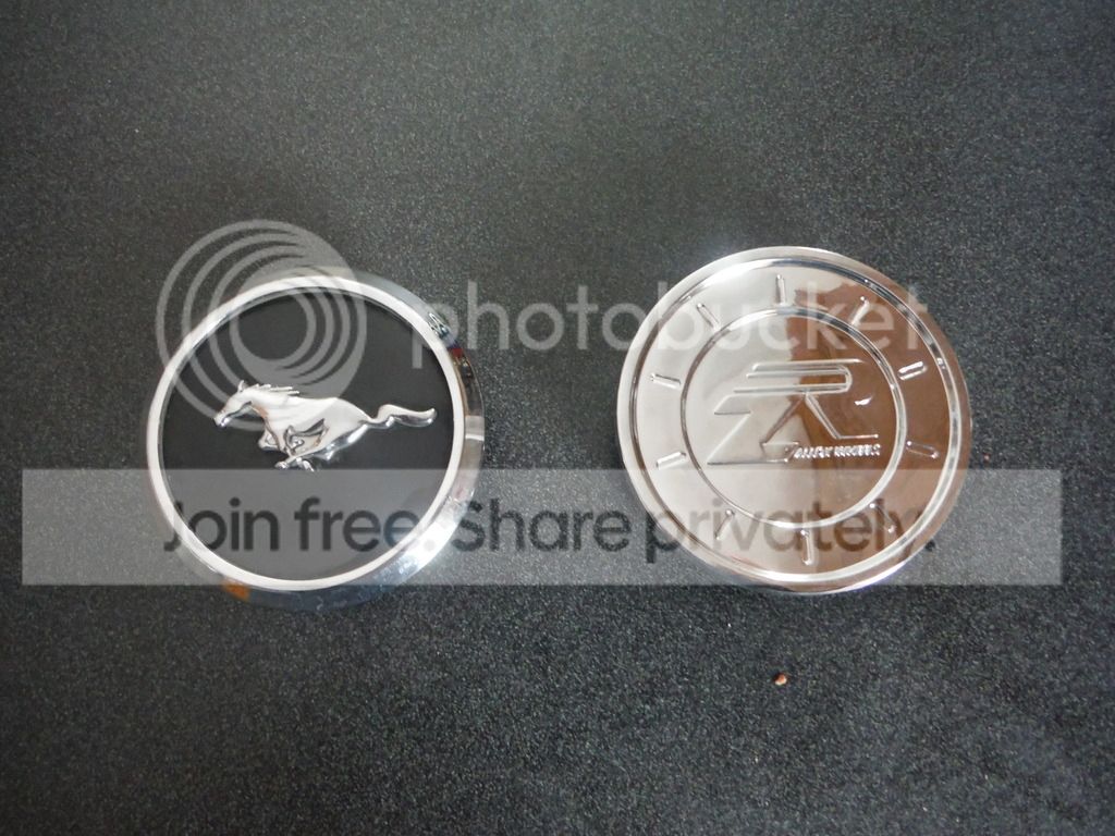

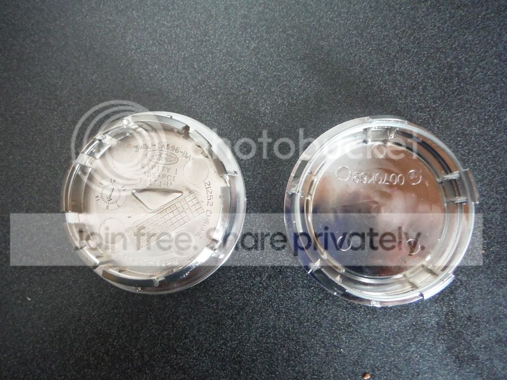

The DF5 wheels came with these cheap looking chrome plastic center caps. Fortunately they are same diameter as the OEM pony center caps on my stock 18" wheels.

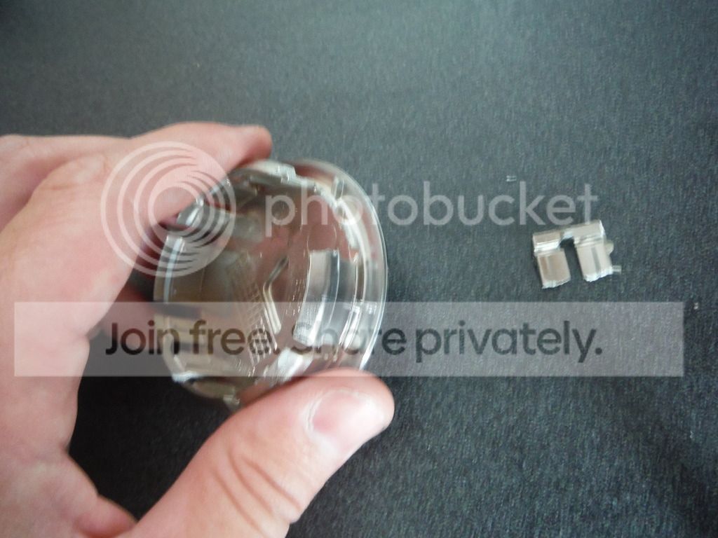

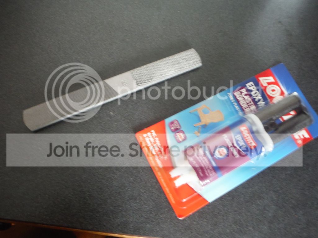

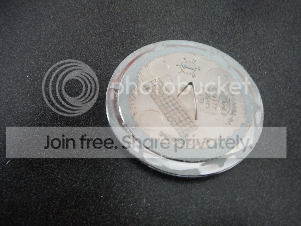

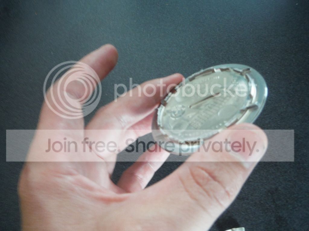

For this project I got a plastic two part epoxy and a metal file (to file down the remains of the tabs on the OEM center caps and other things in the way).

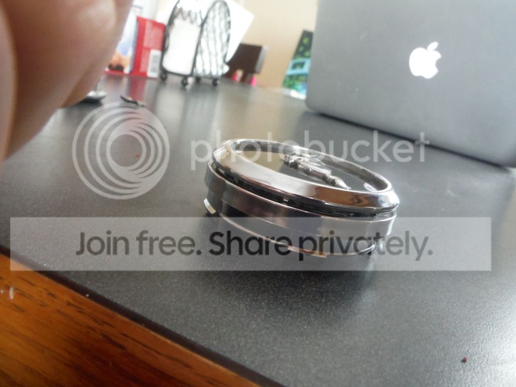

Then I start breaking tabs. The plastic on the OEM center caps are pretty soft, so its not hard to bend then down and snap off clean.

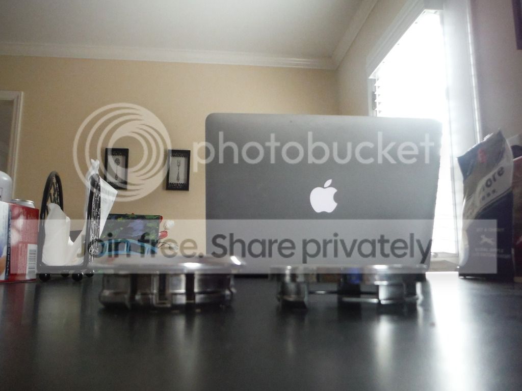

Just to show how close they match up before I start filing away at all 4.

Great work on the center caps. They turned out really nice. Nice design on the wheels, too. But I have to say, they don't fit. The back just looks wrong with them poking out that much & I don't think it's all tire. Too much offset. At least IMHO.

I'm getting 275/35/20 put on to fix it.
S197s use +40 offset in aftermarket setups a lot. Shelby uses +38 on rear 20x10 (Alcoas) Super snake wheels. I wanted a flush look and over shot it with trying to get a meatier tire on there.
I like these wheels as they seem to be the closes in looks to a Vossen CV3 and I can still afford to get the color I wanted. But hindsight I would of tried MMDs version of it with +45 offset; but something seemed off on the look for some reason.
For the wheels to inset more, would require more positive offset. More positive offset increases backspace and pulls the face of the wheel closer to the center of the car.

^^^ This. You all got my meaning. It's a personal aesthetics thing I know, but that specific setup doesn't look quite right to me. The tires don't appear squeezed at all on the wheels. So, yes, more offset needed. Otherwise great wheels--I've looked at that style myself.

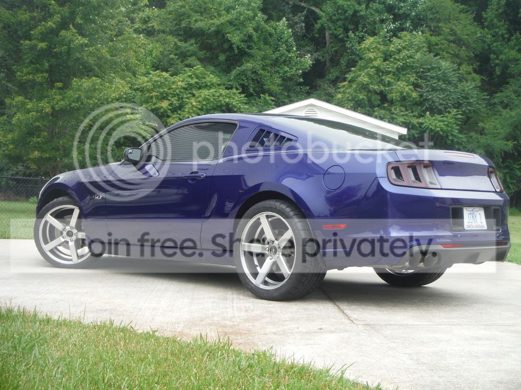

Still need to install rear Koni Orange Shocks, LCA with relos, and UCA with mount.
But here it is the results with 255/35/20 (fronts) and 275/35/20 (rear) and lowered finally with Brembos and GT500 rear rotors (with CNC adapters).
