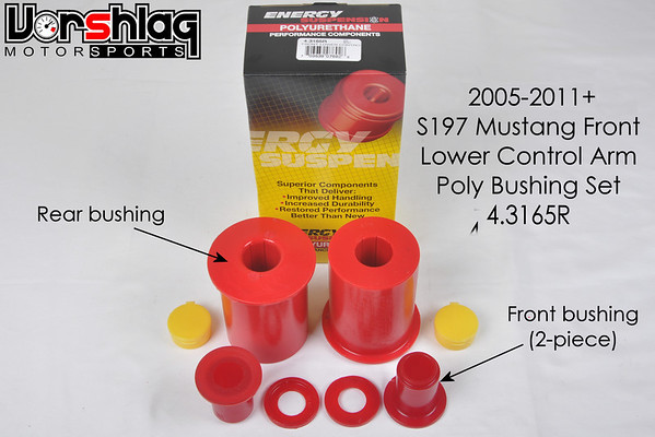

Well the sloppiest bushings on the S197 have to be the front LCA bushings, with the massive hydraulic filled rubber bushing that is as big as a beer can at the rear mount. Frankly it is a terrible design for motorsports use because it allows for a lot of toe change under braking and camber loss under cornering loads. You can see this for yourself - have someone drive any S197 Mustang at about 10-15 mph, stand next to the car and have them stop hard. Then WATCH the wheel move.... ca-thunk!
Now we changed the set of front Lower Control Arm bushings with poly long ago, but on our 2011 GT it threw the electric assist steering (EPAS) into a weird feedback loop that made the car almost undrivable. Ford denied any issues and the dealer couldn't fix it, so we bought a $999 Ford Racing reprogrammed steering rack and the problem was solved. Since then lots of people have had the same problem on the 2011 cars, but many fewer 2012 cars have this affliction, and virtually none of the 2013's have reported this problem when going to firmer bushings or LCAs with new bushings up front. So that's something I would definitely do on a 2013 and might even try on a 2012, if I was tracking or autocrossing it regularly. This is a big improvement for a small outlay in parts... but it is a b!tch of a job to do, and you could screw up your steering rack (almost certainly on a 2011, but a fairly safe bet on a 2012 and almost a 100% safe on a 2013-14)
