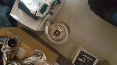

    Found some turbos from a few rebuilds i did a while back one off a c9 acert caterpiller one from a QsT cummins and a random one i found in the shop.

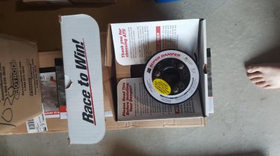

    Ive decided to start with the on 3 88mm CBB with a billet CW. The HR cams have 120° of lobe separation,11mm lift, 240°E, 220°I IIRC. I dont think overlap is an issue. also cams are not a critical portion of a turbo application IMO. Boost is boost, and this is going to be a high RPM engine. Turbo cams would be ideal but i think the HR cams are still a better route than the stock ones(i still have). Further if i experience ANY issues bogging, ill slap a nitrous plate on it..... honestly ill probably slap a nitrous plate on it no matter what. If anyone can provide solid information pointing me away from the HR cams, ill get a custom set made, but untill then a Manley forged crank is likely the most important next step. Thoughts?
    Also the ATI balancer shower up today, not sure if it is worth the 400$. But it sure does look well constructed
