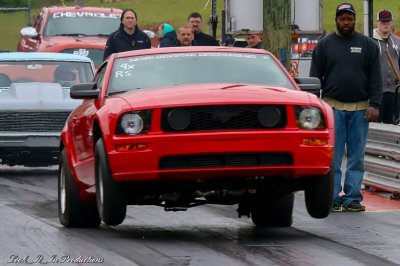

Looking for a "starting point" with regards to how much air pressure I should run and burnout procedure.
Car is 3340lbs, PG 1.80 1st gear, 4.11s, on 15X12 double beadlock wheels. Trying out the new 315/60/15 PRO Drag Radial.

Holy shit that picture is amazing! You have one of the most badass cars here....we should be asking you the questions! LOL I have no idea I only run the MT SS drag radials.

Thank you. Its not for everyone. Its old school.
