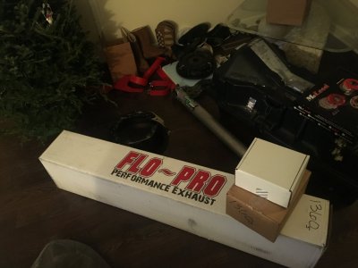

    We’ll see how the 4 grand worth of BMR stuff I’ve bought over the past few months works out, I will say their customer support guy is a sharp dude hopefully he helps design these components.
    I need more help with the aero I’ve started making carbon fiber panel for underneath the car but that’s it so far. And what are your guys thoughts on the trakk pac wing??? I know it’s hideous but it’s functional....
    Other good news. My duramax parts just showed up! Time to dump a hot tune in the 6.6!!!!
