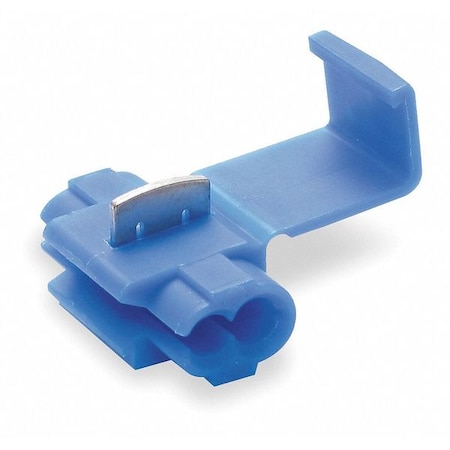

Did they connect the alarm system to the solenoid wire or any other wire with a press on connector? The one with the u shape that you press over the wire and it cuts thru the insulation. I have had it actually cut the wire. Not at first but after a length of time the wire breaks. Let us know after you check continuity of the wire what you find but also check all of the alarm connections.

Thought here with the Alarm install. How are the wires attached to the factory wiring? Are they soldered in any way? Or did they use scotch locks to splice the extra wire? I ask because I had a similar issue with my 86 GT. Battery in Trunk and a disconnect switch. Randomly I would get absolutely nothing. Thought it was my power master starter. Sent back and checked out perfect. Went ahead and traced the wiring since there is a wire tuck on my car it made it challenging. Found under the dash near the clutch pedal, there is a wire as part of the ignition switch that was connected with a scotch lock. Undid the lock and properly soldered. Have not had an issue since.

Thanks for all of the ideas and responses guys! Every little bit helps me, because I'm not a wiring guy lol. I have not seen any scotch lock type connectors, everything seems to either be soldered, or butt connected, even though I did find one wire that was almost pulled out of the connector, but I repaired. As for the solenoid, the trigger wire for it has continuity between it and pin#87 on the starter relay in the Bus electrical center (under hood fuse box), but no power or trigger to it. Shouldn't that come from the PCM or SJB? I know the PCM has 2 pins that are starter related, there is a STR REQ, and a STR ENABLE pin. So I'm guessing my issue is between those, and the SJB. My next question about my question (redundant, I know) is this a PATS issue if that is the case? I'm trying to differentiate between Viper Alarm issues, PATS issues, and a good old fashioned starter circuit issue. And losing hair by the second lol.
