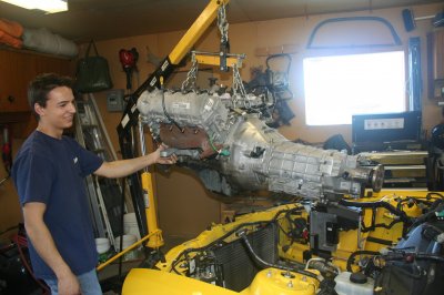

You can still use the leveler. I removed the intake & alternator first and bolted the leveler brackets to the top 2 transmission bolts & the alternator bracket bolts (make sure these are tight as they are small bolts).

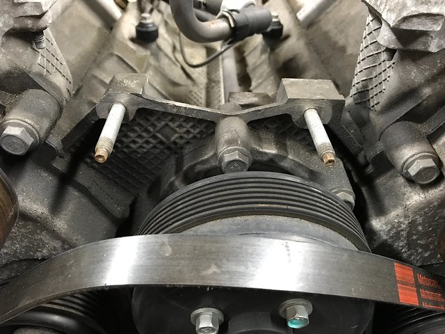

Should I be skeptical of how thin the alternator mount studs are and how thin the wall of the flange is? I had someone else tell me they have pulled many by using the larger bolts visible on the front with the antivibration peice, but I’ve heard many times not to pull from the head.
Are the studs on the front the correct way, or just a convenient way? I know I am very gun shy when it comes to this. Don’t want an expensive mistake?
LikeabossTM
Sep 30, 2015
870
413
Those stud bosses are thick - the thin part you're looking at is the extra gusseting that provides even more structural stability.
I don't know about your engine specifically, but turning bolts all the way into those front holes, as well as the top trans bolt holes at the back, is exactly how the workshop manual instructs to pull the Coyote.
I think you'll be fine.
I think that is the part I am confused about. Are you saying to remove the studs there in the middle where the alternator was and to bolt in the bracket for the lift chain, or is there something I’m missing? Sorry I feel dense.

Remove the studs/bolts circled in red and bolt your leveler in their place.

Thank you all for your help. I also just noticed zoomed in on ILW84U’s top photo, he too has the studs and just used them. I guess I’ll give it a go as is.
Thanks again!

Because those studs are so long, just make sure you bolt the leveler right up against the block. Shoudn't have a problem.

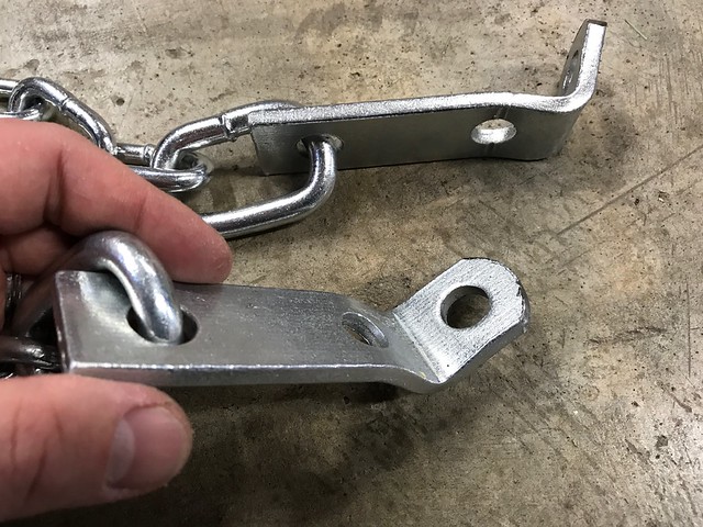

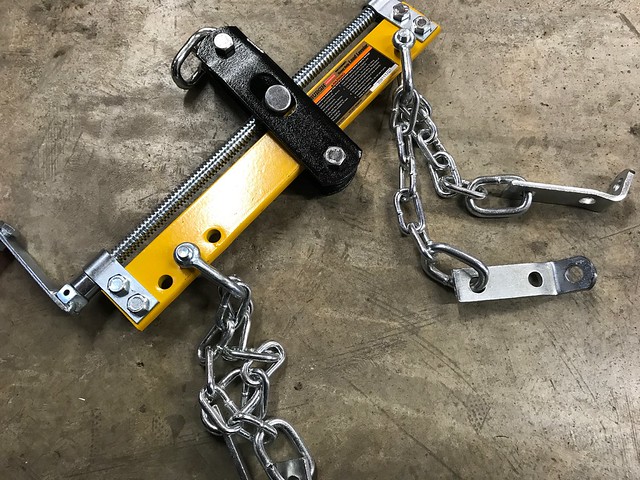

Hey guys, I got some time and tried to pull it today, but had some issues.
I am not sure if I did something wrong or if it is because I had a harbor freight 3/4 ton leveler.
The L brackets started bending quite a bit, and was noticed after the motor started tipping to the right, allowing the left(passenger) motor mount to clear off, but the right was still holding on. The brackets in the back were bending, with the right(driver) bracket bent the most.
I checked all around and couldn't see anything else holding on to it, and because I had lowered the trans, it tilted nicely giving me a lot of room in the tunnel.
The brackets are obviously not tempered steel, and looking at ILW84U's photo, his didn't bend at all.
Do I just need a better quality leveler, and which brand if so? Autozone has there own Duralast brand, and Home Depot had one with good reviews, but none of the specifications mention tempered steel.
