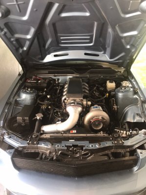

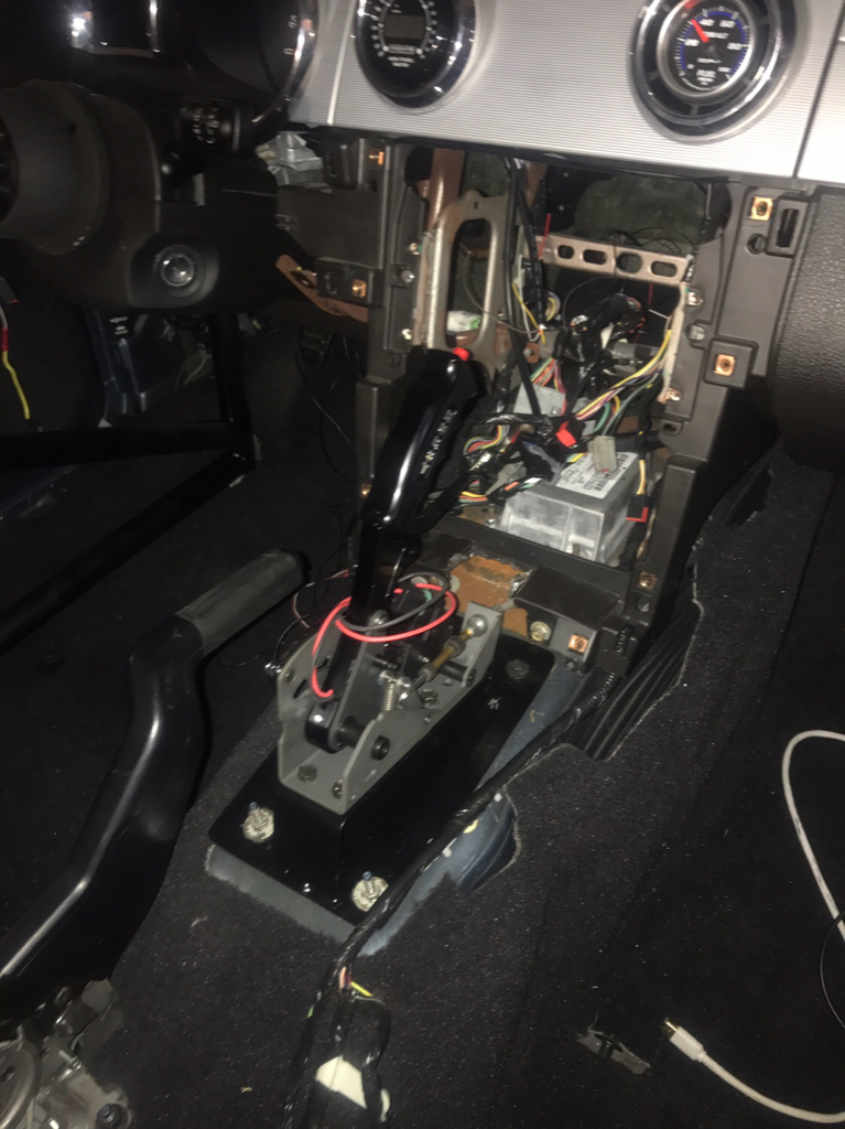

New transmission is in. Cage is painted and carpet it back in.
Need to wire the transmission and all my gauges.
Run new coolant lines and cap the heater core lines from the block/crossover.

Sweet! That's a massive IC, is it custom or off the shelf? And what transmission did you go with? I love the chute mount too..hope to have a need for one myself in the very near future!

It's the new Treadstone 1000hp IC.
Trans is a 4R built by Darrin Burch.

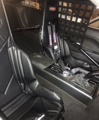

Getting the Interior back in order.
These leather covered kirkeys are nice! Far more comfortable and supportive than the old stockers.

Got the interior wrapped up last night. Just need to find a place to mount chute lever and need to order/install passenger harness.

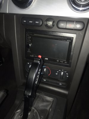

Dam that head unit looks large- surprise you never relocated battery to the trunk with that full jungle gym in the cockpit- engine compartment looks nice-I tried to PM you to give you 2 free tickets for sunday(crew passes) but your mailbox is full- if you want 2 free crew passes for Sundays' 1/2 mile event send me a pm with a email or # to text you. $50 savings)
