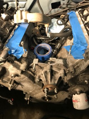

Some update pics:

Lookin' good! What's with the yellow tape and marker on the fender? I'm also very interested to see how you like the turbo set up vs. the blower.
Had hard time getting exhaust to fit out the bumper. That was the next option.
