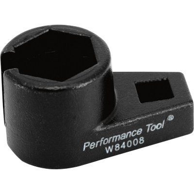

9094116_2000x2000.jpgEasiest to take the h-pipe off and then you need something like this for the drivers side front sensor. Put your 12 or 18in 3/8 extension in it and your socket wrench goes on the other end. Then work it from underneath the car. Be careful with the exhaust manifold bolts for the h-pipe. If you are high mileage they can snap. And they are a bitch to drill out or extract. Spray em down with PB blaster and let it soak for a few minutes and go slowly. They can break just as easy as the damn spark plugs.

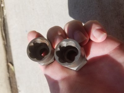

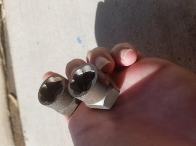

Have you tried an easy out style socket tool? It's basically a set of sockets with spirals inside of them. You put it on over the nut and turn right, then left to catch the nut and remove it. The right size will work. I've used them on lots of rounded nuts and bolts. Cheap and easy. Turn that bad boy til the nut loosens or the stud snaps if you have to. You're replacing it anyway.

Got the exhaust off, without breaking the studs! I was waiting for a complete set of impact sockets with a swivel to come in and they got here today. Very gently with my gun turned way down and back and forth I finally got the last nut off. Now I find that the down stream O2 sensors are NOT coming out of the converters without galling the threads. This jobs just gets better and better. So have to order two more sensors. I still have not gotten the sensor out of the drivers manifold. Been soaking and soaking in PB and Kroil. Will try tomorrow. I hope I don't need heat because I don't see how I can get the torch down to it. And the nuts holding the manifold to the head are worse than the ones holding the pipes on! Got to love a rust belt car, even though this car looks like it was not driven in salt.

View attachment 60442Easiest to take the h-pipe off and then you need something like this for the drivers side front sensor. Put your 12 or 18in 3/8 extension in it and your socket wrench goes on the other end. Then work it from underneath the car. Be careful with the exhaust manifold bolts for the h-pipe. If you are high mileage they can snap. And they are a bitch to drill out or extract. Spray em down with PB blaster and let it soak for a few minutes and go slowly. They can break just as easy as the damn spark plugs.
Rocky, All I can say is you must have been real lucky to get that tool to work! Working from under the car with the cross member out and going up and down as far as I possibly could I could only access that tool from two spots. You can forget the 3/8 drive! I was leaning HARD on a 24" long 1/2" drive breaker bar! hat tool may work fine on a sensor that was put in with anti seize 20K miles ago but not the factory sensors with no anti seize with 96K.
I tried heating the one side of the manifold I could access red hot and nothing. Tried the special socket from the top with a impact universal, nothing. Finally ended up cutting the wires off of the sensor and jacking the engine up until the tranny hit the floor put a deep 6 point impact socket on the sensor with an impact swivel on that and a short extension. There was too much angle to get the gun on it so I was able to get the big breaker bar on it and lean on it. Just when I figured it was going to strip it moved a hair. went back and forth a bit and soaked it some more and it finally came out. I am going to frame that bastard!!!
