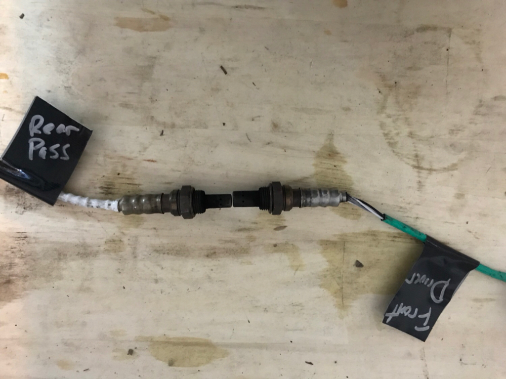

Pulled the OEM ones out last night and the upstream and down stream have different part numbers and sensors look different not just the harness color.
Steve at Tasca replied to my PM and said that Ford now only have one part # for both upstream and downstream
The different tabs is why I ask, at first Rock Auto lists the one I linked as "upstream" in the part discription, however once in the cart the description read for "both".

Original OE out of car
