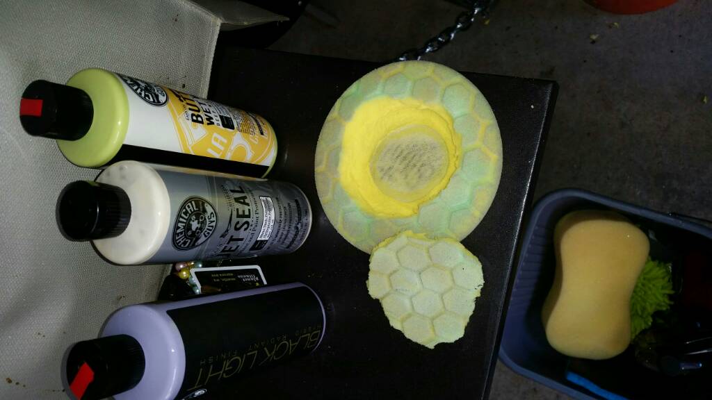

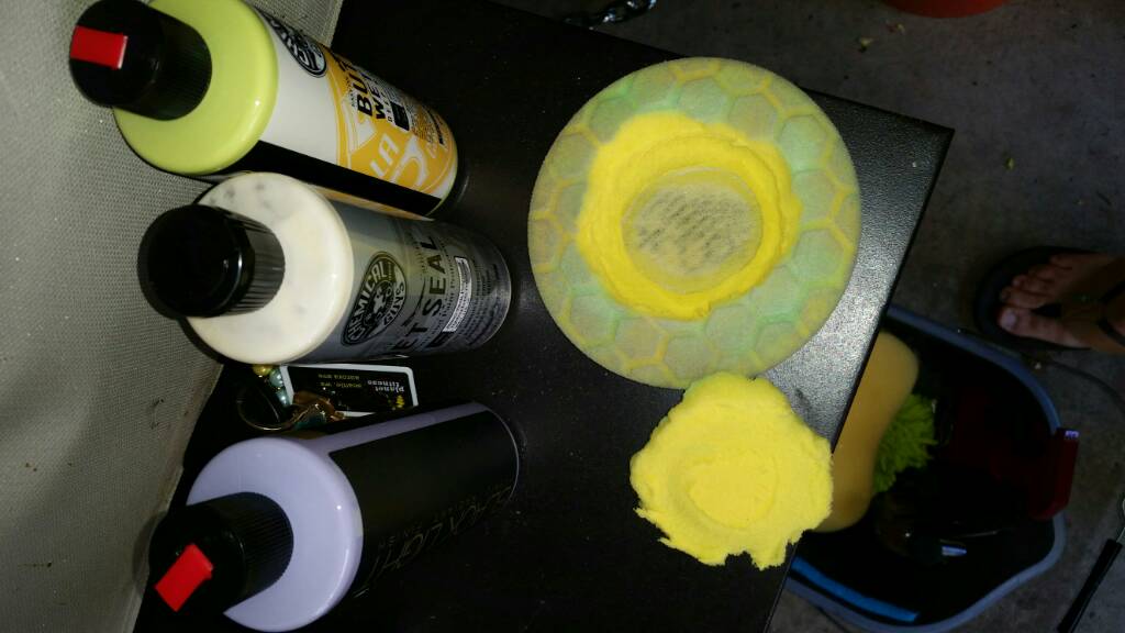

So, I'm using my HF DA with CG VSS to do some mild correcting and using CG yellow hex pad with about 5-10lbs pressure and then this happens. What did I do wrong? I saw some smoke and immediate stopped, accidentally lifted a but as it was slowing down and the middle came flying out. I'm new to this so I'm not sure what I did wrong. Ih, also at the time, there was no direct sunlight on the part of the car I was working on.

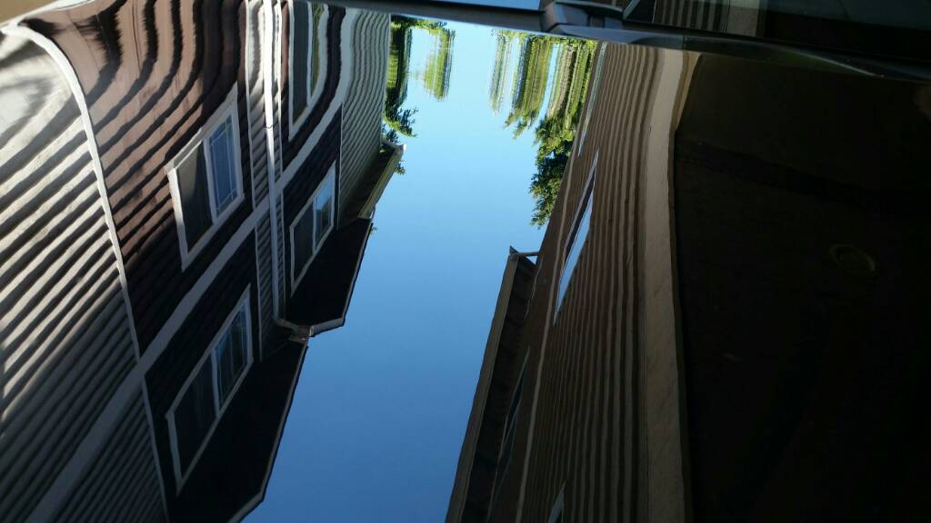

Also, I have these ugly spots, looks like hard water spots. Any hints as to how to get rid of them? Thanks

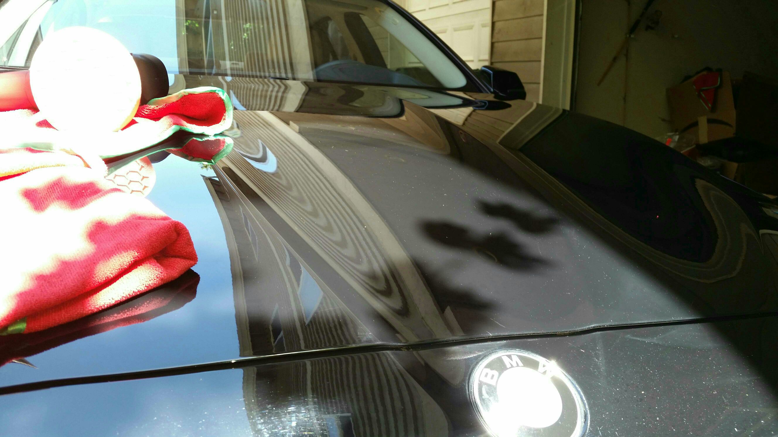

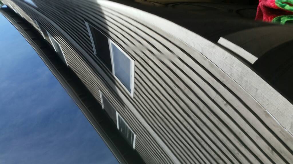

Here's another picture of the spot, there are about 14 more like it. Dang, it's difficult to get on camera.
Finished product :)

I'm curious about what you did wrong myself. I've recently purchased a polisher and CG products, and I'm a tick apprehensive about getting started. Is that pad old?

That was a brand new pad. I guess the only thing I can think of is that I was putting to much pressure on it?

I've pushed pretty hard on some of my pads. I've never had one come apart. As clean as the break looks I wonder if it was just a defective pad?
I have the hard water spots on my paint as well. I think the only way to get rid of them 100% is to wet sand. I've done everything else short of sanding. They've lightened up, but I can still see them at the right angle.

For black paint you will probably need a wool with V32. This will create swirls however, but will totally remove the water spots. Then go to an orange pad with v34 and then finally probably even v36/38 with a yellow and then black pad. The pad ripped as you more than likely did not have enough product on the pad.
Your are pushing way too hard if you had smoke; let the machine do the work, you should not have to push that hard. There are tons of youtube videos on this both from CG and my favorite AMMONYC with Larry Kosilla.

If you hold the pad at an angle (not flat) wih pressurw and speed will cause thw pad to start to tear. Did you do the entire car with that pad? I mean did you start with that pad and use it until it separated?
That is beyond my skill level at this point lol.
Interesting to note that I might have not had enough product. I'll take a look at the pad. Would it matter that I sprayed the pad with pad conditioner prior to starting?
I think, honestly, I want using the right compound. I don't think vss is adequate for etched and calcified water spots.
I did not use that pad for that long. I had started with orange pads, but it wasn't doing the job, so I switched to yellow. This separation happened like 5 minutes into the attempted correction. No angle, flat as can be, working a 2ft x 2ft area.
