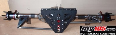

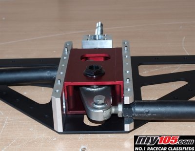

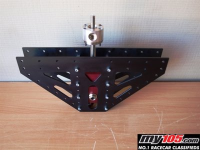

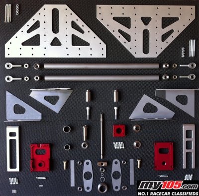

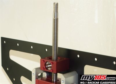

Adjustable Watts Link
Dave, The adjustable watts is mounted opposite to normal. The links are fixed to the rear end and the bellcrank to the frame [with a screw adjustment]
They are very popular in Aussie as a spin-off from V8 supercars. And available as a kit [photos attached]

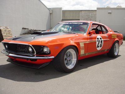

My brother has one in his 69 boss race car. he said it is great for fine tuning for different track conditions [he doesn't use in-car though]
Photo attached of my brothers race-car [a genuine "G" code 69 boss]
