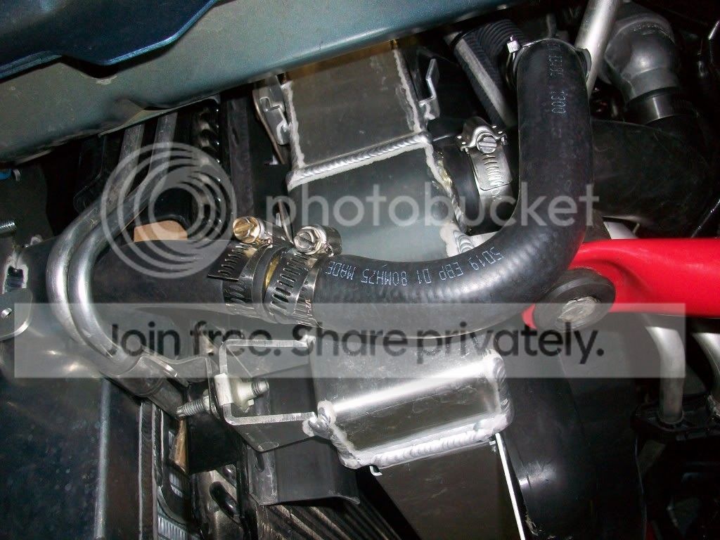

For those of you considering installing an Afco heat exchanger w/Saleen I/C pump, routing the hoses as others have suggested is a much better/cleaner way to go. The original routing I used in the beginning of this thread has far too many elbows, connectors, clamps etc. and I'm sure was resulting in restriction of coolant flow. This was a perfect example of headuptheassitis. As you look at the first picture of the revised hose routing you'll see the RH brake cooling duct on the GT 500 fascia I mentioned earlier. However, that's no excuse for not routing the hoses this way to begin with. Just takes a little better planning and attention to detail so the hoses aren't kinked which restricts coolant flow.

So are you running the pump into the passengers side lower fitting on the H/E and the output from the upper fitting?? Essentially pushing coolant through the H/E bottom to top?

You read my mind as I had originally hooked mine up routing the pump to the lower inlet, but was concerned about it restricting flow by having to push the coolant up through the H/E. With my new 180 degree silicone elbows though, my flow should be fairly free flowing using the upper in/lower out... but I may revert back to your set-up after seeing how it performs when I finally get to start driving it again.

I spoke to several shops about this very issue as well as looking into several different S/C (Saleen, KB, Whipple, etc.) manufacturers/installations and have seen the inlet/outlet hoses in both the upper and lower configurations. Some shops recommended the top fitting on heat exchanger as the inlet while others recommended the bottom. All agreed that using the bottom fitting as the coolant inlet would help to remove (purge) trapped air from the heat exchanger during initial fill and under normal operating conditions - similar to the way the I/C reservoir does for the entire I/C system.
The only real way to resolve this discussion would be to data log AITs with the hoses routed both both ways and see if one routing is more efficient than another.
Unless I see a problem with this current routing I'm not going to go to all that trouble. Just the reduction in hose, elbows, connectors, etc. probably offsets any restriction in flow required to force the coolant uphill so it's probably a wash.
I can tell you just by looking at the rate the coolant is returning to the reservoir (I know not very scientific) I see absolutely no difference with the hoses routed this way.
