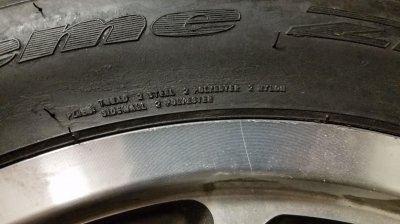

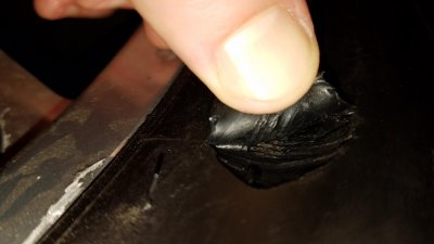

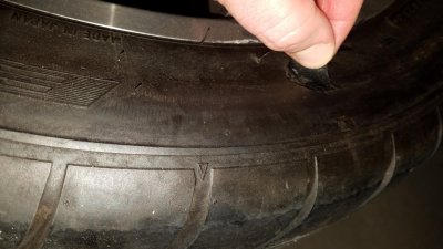

Ok Racer47, here is the best I could get. I attempted to cut off the rubber flap, however, I'm not as good at cutting tires with a razor as I thought. So I got it all cleaned up to the best of my ability and got the camera in as close a possible to get the most detail. I hope this helps.

Racer47
Doesn't have much to say
Sep 11, 2009
1,065
324
SE Wis
I don't see any cord material on the rubber flap. The exposed cords don't look like they are cut. Also having 2 sidewall plies is more durable than 1. It should be ok
Get some 3M black weatherstrip adhesive. Glue the flap down and run it. Just check it once in a while. If it starts bulging its time to replace it.

Excellent, Thanks for the info. I hate having to throw out a tire with good tread on it, if it can be saved. I'll glue it back down, monitor it and only use it for normal driving conditions.
