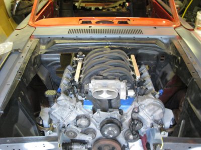

    I continue on my quest to swap (the easy part) and get running (the harder part) the 3V out of a 2006 mustang, now with an E-Force Supercharger, into my 1965 Ford Falcon Hardtop protouing car.
    I have the engine and transmission in the car, everything fits nicely with some shorty headers, I tried long tubes but the narrow Falcon frame rails make it a no go.
    My current challenge, cooling. I have a Fluidyne radiator for an S197 and have it fitted. But what about coolant routing? The Edelbrock E-force requires moving to the 07' and newer coolant flow layout, but if I am going to spend the money, is there a better/cleaner way to route the cooling lines? Or just go with the 07 routing? I will be doing a custom Ron Francis wiring harness and tucking everything I can and cleaning up all the stock cooling line mess would also be nice. Any thoughts or advice?

    Here are a few pictures. No pictures with the blower yet, just picked it up locally this past weekend.

    So anyone have any thoughts on the cooling. Do I just go 07' up routing and call it a day or is there a better way?

    I have the radiator already. Fluidine for the S197. It is huge compared to a stock Falcon unit but I figured out how to make it fit. Should give plenty of cooling. The question is how to most efficiently and visually cleanly route the coolant hoses themselves.

    Broke down and just ordered the Edelbrock Upgrade cooling kit, hopefully it will all fit given I have less room in the engine bay than a normal mustang would. Also ordered a 05 trans crossmember so that I can mount it to work with the Blowfish Racing shifter support/driveshaft loop setup. I had made my own custom crossmember before but it will not work with the BFR support and I wanted to not have to mount the MGW shifter to the Falcon trans tunnel.
