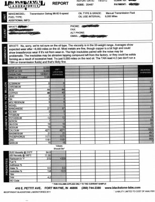

As there has been much talk about what type fluid our trans have in them , I guess it depends on when they came down the assembly line . I changed the fluid in mine a few weeks ago,Amsoil 75w-90 in it now and can report that the trans shifts better, and a lot less noisy ! Is it perfect , no, but then I have found few trans that are perfect all the time. Can I live with it and enjoy the car , yes.But when I changed it out , the first thing I noticed was the smell , and it took me a few days to figure out what it was that it reminded me of,the yellow 3 M adhesive ! Now what is in the both the oil and the adhesive ??? Not sure , it will take someone smarter than me to figure that out lol. But I also sent a sample off to have it checked to see what it looked like and I am glad I did !
I know that some of you think that the best thing to do is just run the oil that Ford shipped it with and it will all be good , but if you look close at the results of this and some other samples you may want that crap out of the trans .

I am not sure who makes this oil for Ford, but the 75w-90 that walmart sells test better than this stuff lol. What really had me worried was the tan reading , 4.2 , and what they thought it might be, " The insolubles may be abrasive compounds left from the factory , or they could be solids forming as a result of excessive heat ." This car has only been driven to car shows and to the mountains a few times and it is building up "excessive heat " ? And lets just say that , well this trans runs a little hotter than others, ok. Well then they should have put a better grade of oil in it that WILL NOT brake down so fast.
I was really expecting them to find more lead it in than they did seeing as it was made in China . LOL
You noticed the acidic level of the fluid was rising too, so did I. Not desirable.
