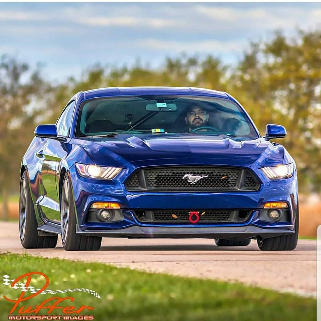

275/45/18 measures out to about 27.7" tall
I've run a 275/40/19 on the front of my car, which measures out to 27.6" tall, and I had no issues:
I also briefly ran a 305/40/18 drag radial on the FRONT, but that's another story, lol ...
(no rubbing :) )

Haha that’s such a wide front! That’s racecar status right there.

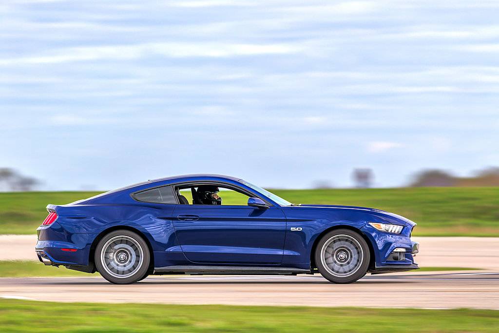

Lol. It was for an autocross event.
Ran the same tire front and rear, Nitto 555R, fronts were 305/40/18, rears were 305/35/20.
The fronts did amazingly well, especially considering they were mounted on 9.5"-wide wheels, so sidewall bulge should've had them flopping on their sidewalls.
But they did awesome:
