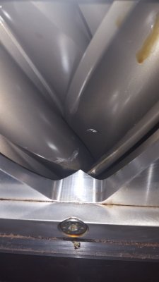

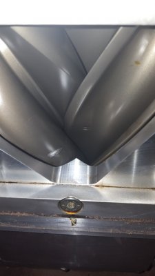

Last year while racing my car inexplicably started going slower and slower at the track. Then it died on the last pass. I pulled it out of the trailer and saw there was a low oil warning on. I shut it down and later pulled the oil filter. Full of metal. So I saved up enough cash and am in the process of pulling the motor. I pulled the blower off and I saw these rather deep and substantial gouges in the screws of my blower. I won't know what the real cause is until I pull the entire thing out, pull the pan, bearings and valve cover but anyways...I was slightly disappointed.
Whatever came through, was substantial. Odd since I've never ran without the filter.
