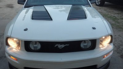

Can you send me some pics of that hood you got with some good shots of it closed and opened when you get some spare time? I would appreciate it.
When you switched to that hood(from stock?) could you tell any difference?
I did, actually. Less front end movement at high speed, being the major one. I'd like to say it runs cooler, but I never had a temp issue in the first place...which also makes me wonder about people who claim this about any hood.
I've attached a couple shots. On the shot of the hood open, the lining you see is weather stripping I've added for aero purposes at the suggestion of one of Ford Racing's aerodynamicists, as an experiement...that so far, has virtually eliminated hood flutter. I've since added a strip at the back, as well.
If you want any angles in particular, let me know.

I have crazy heat problems. whipple 2.9 at 16psi on my pig. The car runs cooler with the hood. It takes longer to heat soak too. I have no weather stripping and the hood does flex / bounce a bit at 160 but I also run 4 aero catch pins at the hood bumper points. I think I might try the weather strip idea. What exactly did you use Grip?
Hmm... can't say I remember the brand, but any adhesive weather stripping should do. Judge by eye, but 1/2 inch or thicker will do the trick. If there isn't already one there, another strip at the leading edge of the decklid keeps air from trapping itself in the trunk.
It's not the only aero treatment to be done, either. More on that when I can get the time to do it.
