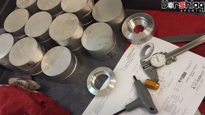

CNC Machines Roaring at Vorshlag

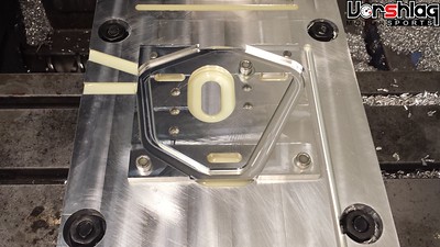

Much of why this update is so late is due to the fact that I've been feeding metal into our new CNC machines all day every day for the past 2 months. I have a laptop out there just to check emails, but with short cycle times and 3 machines to tend to I often don't have 30 seconds free every few minutes. Its crazy, but its part of the ramp-up needed to become more self-sufficient in our CNC parts supply, at least until we add more staff to cover this.

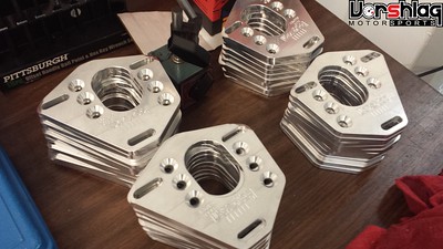

Not only have we made batches of S197 Mustang camber plates we are running most of the 20 other models we make as well. And we have to make the fixtures (tooling) to make the parts. And sometimes tools to make the tools to make the parts. And there are many weeks left before I get much relief - only reason I had a break to write this quick S197 update was we ran out of material last Friday, then had an autocross school we taught at on Saturday, but was free on Sunday for the first time in weeks. Whew!
During this whirlwind of activity, Vorshlag engineer Jason managed to design and machine our first set of S550 camber plates in 48 hours, from start of measurements, design work, final CAD drawings, CAM programming and machine work. We had some pieces laser cut overnight and Olof fabricated some parts as well. These went on Aaron Sockwell's 2015 GT from Dusold Designs and he ran the Optima event in this car with a podium finish the next weekend.
These are our prototype Vorshlag camber-caster plates for the 2015 "S550" chassis
We also installed the first MCS coilover kit for the S550 chassis on his car that same week, which was built from Vorshlag drawings by MCS in short order. This set of TT2s and the spring rates we chose, combined with the 18x11" wheels we helped spec and the camber plates we supplied, have transformed this already quick pony into something that can seriously compete with the best of the S197 Mustangs. Good stuff.
The first MCS coilovers for the S550 chassis were made from our drawings, fit great, handled awesome and rode perfectly.
We are working with MCS to make a batch of these S550 coilovers but we still need to complete the rear spring platforms, as well as make a batch of the S550 camber plates, then design the OEM spring perch solution for those. Lots to do...

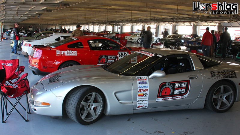

I managed to sneak in an update on our TTC prepped 1992 Corvette (#DangerZone) since my last Mustang post, which shows the prep before the recent NASA @ MSR-C event. I will have a race report from this event below, covering this TTC car and our TT3 Mustang (I drove both).
Lots of cage and suspension work was done to this car, which is also detailed in this March 12th "This Week at Vorshlag" video.
Also kicked off a new project for Mark Council's 2002 Corvette which is now being built with an eye towards NASA TT2.
I raced Mark's C5 with almost no updates at the Optima TMS race, which I will cover... next time. The C5 build thread can be found here and we will post links there for other forums where we will update this one as well.

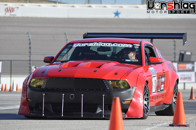

Driving around COTA during PWC race weekend with Optima, March 6-7
As much as I complain about the rules, I really do like the Optima "Ultimate Street Car" shootout and the USCA qualifier series they started last year to finally allow racers to WIN their way into the big show. We've done 4 or 5 of these qualifiers over the years now, as well as the the OUSCI shootout last November. And while I had some issues with that event, they took racers' feedback and made some big changes. So when they needed some former Optima racers at their booth during a World Challenge race weekend, Amy and I said we'd be there.
North Texas had some FREAKY weather the day before we left to go to this PWC event, as shown above. Snow, and lots of it, in March. I've lived here off and on since 1978 and I've never seen snow here in March. Made for an interesting drive to work in the truck and trailer, but the guys got the Mustang prepped and loaded as this mostly melted off before we blasted the 5 hours down to Austin Thursday afternoon.
Getting to take some laps around COTA is a good draw, as were the free pit passes. And no, this wasn't a "competition event" for our Mustang, more of a car show and a few fun laps around the F1 track.
We did have fun there on that Friday and Saturday of the Pirelli World Challenge weekend and met a lot of new folks there who follow this build thread. We helped round up three other cars for the Optima trailer display in the PWC paddock area (thanks Tim and Costas!), after some car owners flaked out at the last minute.
I'm glad we went to this, as it gave us a chance to talk with more of the Optima folks, as well as meet some other great vendors like the Recaro people and others. I happened to give the head of Recaro a ride around COTA in our 2011 Mustang, on street tires with NO REAR WING, and it was a handful. Amy drove the car Friday during the lunch break and I took laps both days; on Saturday I was in our car and on Friday I borrowed a racer's 2005 Mustang for some laps.
I have video of both days but these were more "80% pace" fast-ish parade laps and not as entertaining as a full-tilt video I would normally share. Such a beautiful track, and I wish more groups could afford to race here, but the track rental costs are still just way too high. When/if NASA ever has a race weekend here, then I'll come back and run this in anger.
The lack of rear downforce (Optima asked us to take the wing off to better represent what their 2015 rules allow) was abundantly clear, and I decided then and there that we needed to make a rear spoiler for this car if we were going to run it in the Optima at the TMS event. Having the car get LOOOOOSE mid-corner at 100+ is not fun! The car was also running pretty rough when I drove it, and Amy mentioned the same thing. Would clear up at WOT but part throttle was bad. Hmm.
We had hundreds of folks stop by and gawk at the Mustang, and it looked good sitting still as well as blasting down the back straight at "whatever we did" (not admitting to the speeds we drove when out of eyesight of the pace car). The PWC classes were also fun to watch practice, qualify and race, especially GT3 and GT4. The 2 minute video below shows the variety and awesomeness of the big GT3 class.

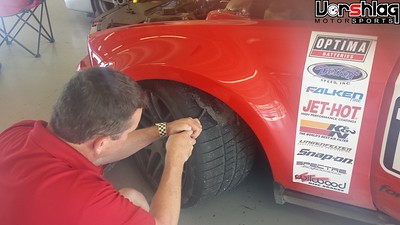

Mustang Prep Before NASA @ MSR-C
The shop was so busy working on customer cars and our 1992 Corvette that the 2011 Mustang got very little attention prior to MSR-C. We didn't even decide to enter TT3 until just 5 days before the event, after some things I had seen on the Corvette, so we had to scramble a bit to get the car ready.
I got 99 problems and.... not having enough tire storage tires is one of them.
Tires were a problem. The last set of four Hoosier tires I won in 2014 got botched and we received 4 rears (345) but no fronts (335). That was long after we had "sold" the car so I didn't worry about it, but when the sale fell through (3 different times) and we had this event pop-up, we had to go for a used set of fronts and some fresh A6 rears. Fronts came from last year's April TWS event, where we had a hard weekend with 2 drivers beating on the tires. We had another a new pair of 345 A7 rears, but with nothing but worn 335s for the front, I didn't want to make that big of a grip imbalance.
Fresh fluids went in, including 15W50 Mobil1 oil (not 10W30 as shown!) and Motul RBF660 brake fluid
I almost went with scrubs out back as well, but we are going to move to A7s soon so I wanted to use up the last of the sticker A6s. This car is also a real bear to drive with no rear grip, so we went with old fronts + new A6 rears, knowing it would probably make the car understeer or "push" a little bit - which it did. Calculated risk. Pads/rotors looked good so our guys changed the oil and pushed some fresh Motul 660 through the brake system. MSR-C is easy on brakes.

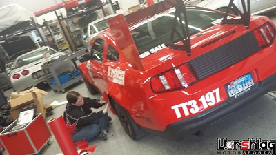

The wing went back on, of course, and Jon made some new TT3/197 decals for the side and Hoosier decals for the fenders. Other than that, this was the same set-up we ran at Optima back last November with almost no changes other than the tires. Since we would be running Optima soon, I had them keep the 2nd set of 18x12" Forgestars mounted with the BFG Rivals mounted on that. We brought a spare front and a rear (used) Hoosier tire along in case we had one go down on us and figured we could have it changed at the track.
The funky engine running issues were thought to be fouled spark plugs, as we haven't really driven the car in many months other than to move it out of the shop to work during the day. A new set of Bosch Iridium spark plugs were installed and it seemed to run fine, so maybe that was all it needed? Amy cut some red vinyl sheet and placed it in front of the fender flares at all four corners, to protect the new paint. Need some clear PPF applied....

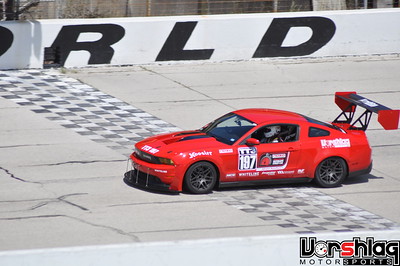

Pretty minimal pre-race prep, considering we haven't done a NASA event in this car since last June. So with the tires we had I wasn't expecting much better lap times than last year, when I ran that 1:17.3 TT3 record lap on the first weekend ever to try the 335/345 Hoosiers. That 2014 NASA Cresson event was a hectic weekend with Traction Control troubles but the car was blisteringly fast on the new "big tire" set-up, and probably my best showing in NASA during the 2014 season. The 1.7 mile course really favors aero so we hoped the new wing mounting and "lower drag" front flares might be an improvement? How close could we get to those 2014 times on two scrub tires?
Could we beat the 6 other cars entered in TT3 this time? Could Amy push hard enough to win the class on her own - when she had only ever mustered as close as a 2nd before (behind me)? She is closer to me at ECR but hasn't run the 1.7 mile course at MSR-C much, and never on the 335/345 Hoosier set-up. At least we wouldn't be running the dreaded 3.1 mile course, which is nothing but a giant traffic jam.

So that means no worthwhile points for the TTC entry, but two solid "100 point days" for our TT3 entry, if we end up having the Mustang all season (it's still for sale). Four fresh Hoosier A7s (in the right sizes this time, yay) were won here, so we'll have fresh tires on the Mustang at TWS in April. The original set of 245mm R7s still only have about 8 laps on them in 2 race weekends and look great, so we'll run those on the C4 again at the next event (only won 2 new tires at MSR-H in this car).
So the smoking issue and metal in the oil pan can only mean one thing: the the 24 year old LT1 motor needs to be rebuilt. That's two events in a row smoking and/or leaking oil in the C4, and I don't want to get a reputation for that nonsense. I want the motor rebuilt, back in the car, re-dyno tuned, and a track test day completed before #DangerZone goes back to a NASA event.

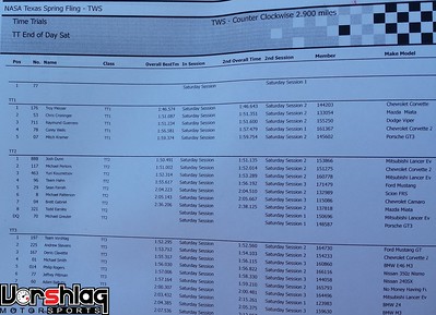

The Mustang must have been weighed 4 or 5 times all weekend, but it was never close to being underweight. We gained some weight somewhere, as it was always about 70-90 pounds over the 3802 pound minimum all weekend, but I kept taking ballast out until we were closer. The C4 only made two laps, in two sessions, so it never had a chance to get called to scales. It was well over the 3203 pound minimum, as I kept topping off the fuel tank and the added mass of the front cage section was also present.
Left: Saturday TT Results. Right: Sunday TT Results
Official Results: http://timingscoring.drivenasa.com/NASA_Texas_Region/2015 - Official Results/MSR Cresson/

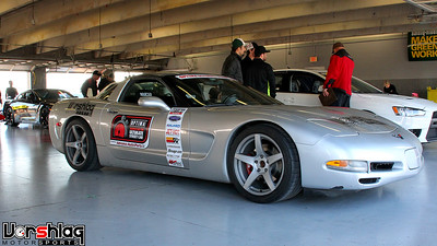

We were looking forward to this event, and I really wanted to test out Mark's 2002 Corvette before Optima at this event. As usual prep on anything I drive runs behind scheduled customer jobs, so the C5 didn't get much attention other than the new 18x11 wheels and some 295/315 Rivals mounted, but that was enough.

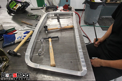

Above: Construction of custom splitter version number 3, AKA: the "C Prepared" Splitter
Ryan also made a new front splitter for the Mustang that Amy wanted to test. The new rules for USCA/Optima disallow any rear wings worth building, and we ran out of time to make a rear spoiler (that we'd likely never use again), so I asked the guys to make a "short" splitter to reduce front downforce. I had also looked at possibly running some SCCA autocross events and the only class that the car remotely fits in was C Prepared, with no wing and a short splitter (or SMOD). So we followed the CP ruleset for the "shorty splitter" and it follows a "top-down outline" of the OEM bumper contours. Short and sweet, with no need for the four support struts, this version allows for more street use; it has better ground clearance with the lower overhang.
Left: Custom splitter version number 1, used at Miller in 2013, was 10.25" long. Right: Custom splitter version number 2 was only 6" long
This makes the third splitter we've made for this car, starting with the original 10.25" we ran at Miller in 2013, the 6" splitter we've run all through 2014, and then this 2" splitter for CP/Optima use. It looks weird without the wing, to me, but the new rules just forced us to do this.

Next up is a hood vent job we did for a supercharged, open track Mustang. Lots of underhood heat and 4 heat exchangers, but nowhere for the BTUs to go, so we came up with a plan to add some serious extraction. The customer really wanted a "carbon" fiber hood, but we warned him there would be little or no weight savings. As you can see it saved 3.1 pounds, which is about what I expected. While still a quality part, the Seibon branded hoods like this are a "composite" construction of fiberglass with a layer of carbon weave on top, as are virtually ALL "carbon" hoods.
Jason and I put our engineering hats on and looked at the shape of he hood, some data of these cars tested in wind tunnels, available space underhood for airflow, then came up with where and how large to make the opening. This is essentially where the a GT500 hood vent gors, but about triple the size. Olof cut the hole then built an aluminum frame to match the hood contours using a lot of shrinking and stretching, welding and grinding, sanding and fitting. Customer wanted this to look NICE so extra time was spent on the finish work.
The final frame and louver assembly looked amazing, and the top edge (which was to be bonded to the hood) was left rough for better adhesion. Every other surface was sanded and perfected to a brushed finish. Lots of hours but it was worth it. To keep from having visible hardware on the carbon hood surface, the frame was bonded to the underside of the composite with the appropriate epoxy. This was held in place with the green tape (above right) while the epoxy set-up, which was kept clamped for 48 hours.
Four "Quik-Latch" brand quick release hood pin kits were added and the OEM secondary hood latch was kept as a backup. The finished result is pretty amazing and this, plus a lot of other work we've done to the car, helped the owner place well in the Design and Engineering competition at the Optima event in March.
These changes helped keep the temps down and he was able to really push the car around the TMS infield road course during the Optima event, placing 6th in the Time Trial portion in the GT class competition. If you click the above right image you can see the "heat plume", with waves of heat pouring out of the hood duct. The car is back in again for some underhood "relocation" of the two coolant reservoirs, moving them back to the OEM battery location (and the battery to the trunk), which will open up even more room for a proper radiator duct to the hood. Will show that next time.

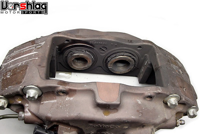

The brakes needed the most work. We had a caliper "de-thread" at the mounting holes at the Las Vegas Optima event. I wrote about it... well, in the ranting race update that I'll never post. We also had a front rotor issue there, so some Autozone replacements went on. They didn't last two weekends (NASA @ MSR-C + Optima), but the cheap stuff usually never does. So a new set of Centric Premiums went on along with a fresh set of Carbotech XP20 pads front and rear.
If this were gong to an autocross I would have had the guys keep the pads on, as they had about half pad depth left. But for a NASA event at Texas World Speedway? Where we might be going into a braking zone at 150+ mph? No, I don't want to ever risk brake failure again like last year at RA. So we went with fresh pads, fresh Motul RBF660 fluid, fresh Alcon caliper temp strips, and fresh rotors. We even put on a fresh set of Brembo calipers up front as well. Look at the image above and you might guess why.
Slowing down 3802 pounds of Mustang (with driver, fuel and ballast - to reach TT3 power-to-weight limit) isn't easy, even with massive 4" brake ducts and good fluid/pads. It takes its toll after 5 years, and this is now our 2nd set of worn out calipers. The dust seals were fried and the were just ready for a rebuild. The scratches in the upper sections were from gravel picked up during the "off" at RA and ground between the calipers and wheel barrels. The inside barrels of the front wheels got similar rock rash but had already been replaced.
Instead of a messy, time consuming caliper rebuild, it is just cheaper for us to buy new calipers from our Ford source, which we use in our 14" Brembo upgrade kits. One of the old calipers had already been heli-coiled (Vegas) and the other was showing signs of worn threads. We didn't want to risk more abuse so they are now new, as are the Brembo clips and pins with new bits.

This is what happens when I'm lazy and don't bother to make a proper part for a car we're racing. I went with something else and it failed. Bah. Oh well, we gathered up a lot of the polyurethane and Nylon bushings we use in our BMW motor mounts and we found some better materials to use.
Olof and I tested out the cutting speeds on the lathe and he whittled down a pair of 95A durometer red poly bushings and rebuilt the passenger side motor mount. The main plate was straightened in the press and it went back in better than ever. We will look at making a proper motor mount for road course use in the S197 next.

Since I wasn't going to be driving our Mustang I rented frequent Vorshlag customer Mark Council's 2002 Corvette (aka: the "eBay special") that I entered in the GTS class (above left). Neither Amy or I did all that well, but we still had a lot of fun and are both glad we went. There were a total of 11 entries from Vorshlag, from employees to customers, and we all had fun at this event. Remember that when reading my rants below that all of these issues were caused by the car I borrowed, which was untested and modified in weird ways. We've since fixed almost all of these ills, but we only had a few days before this event to repair some broken parts, and I took it with just a quick wheel/tire upgrade that we put together.
Funny thing happened - When I signed up the C5 Corvette in GTS class (for 2 seat cars + AWD cars, over 3200 pounds) there were only 6 in class and 5 were novices, and no AWD cars. This was only a week before the event. Well somehow the GTS class grew to 16 cars, with some cars moving up from GTL, and 7 of the late entries were AWD cars. Those types of cars compete exceptionally well at the standing start Speed Stop and Autocross events at Optima, especially the way that they set up their courses. That influx of late entry AWD cars was an unexpected surprise.
This made winning the GTL class no longer "shooting ducks in a barrel", as some seriously fast AWD cars were now balanced between both GTL and GTS classes, with some hot C6 Z06 entries in the mix in both as well. The 4 seat, 3200+ pound GT class was also stacked, and the vintage class (GTV) had some of the nation's top Goodguys competitors. There would be no easy wins this weekend!

Doug Willie brought his "F Street" prepped 2013 Camaro autocross car to give this event a try also. Doug did really well and took 4th in the GT class autocross in a stock 2013 Camaro 1LE on skinny 285mm Hankook RS-3 tires (he was saving his 305 Hankooks for an upcoming National Tour). So once again skill > parts, at least in the autocross.
So when it came to our two primary cars, Amy had to run the autocross in the morning Saturday while most of us ran the speed stop. She was shown in 2nd place at the autocross in GT class after the ~3 hours of morning runs, but as the course "rubbered in", the afternoon cars went much quicker and she fell down to 6th place in class (Jon got 5th while Doug got 4th behind the 3 race cars that swept the podium). Bummer. She had never done a Speed Stop event before but persevered and took a whopping 18 runs on that course (next closest was 13 runs). She scored her best time (10.9) on her LAST attempt, placing 6th in class for this event. The chances at that $3000 prize weren't looking good.
And it continued to worsen as Amy's worst event in the Mustang was Sunday in the Hot Lap challenge (time trial), where she struggled to get 9th out of 26 in GT class on the road course. Why? Several reasons. She had never run the 1.1 mile TMS infield road course before, had never run this car on course with street tires and NO aero, and she said the car was WICKED loose. When all you are used to in your car for the past 3 years are 345mm Hoosier A6 tires and big downforce, it can be hard to adapt to no downforce and street tires. Lack of rear grip kept her cautious all day, but I was trying to motivate her and kept telling her to PUSH IT.
Well she did push it, and on the opening laps of her 4th session on track (we all had 6 different 15 minute track sessions on Sunday) she spun it into the infield, shown in this short video, shot from Matteucci's C5 (with a potato for a camera, #potatocam). I couldn't get her to record any of her own video in the car but she managed to have one of the AiM Solo's that recognized this track, so she at least had lap times. And her spin was in good company, as Jon and Doug from our crew both had spins, and as you'll see below, so did I.

I fought the eBay Corvette all day Saturday in the Speed Stop then the Autocross event, cursing up a blue streak and even making up some new words. The Koni 3000 series dampers are way too long and only work at really TALL stock ride heights. With a 1/2" of lowering on the previously installed aftermarket spring bolts the car had virtually no rear bump travel (1/4"!) and would bottom out simply under acceleration, as well as whenever I hit any actual bumps or dips on course.
Handling was flat TURRIBLE, but the braking was a big hot mess as well. The Hawk HP+ front pads were overpowered by the racier (Hawk HTC?) rear pads it had installed, and this threw the brake bias off so much that not even the C5's ABS could keep up with. This video is my 8th autocross run of 9 attempts, and one of the few where I managed to point it between the cones correctly. From the clutch to the shifter, brakes and handling, what a total MESS this car was. Of course it should have been tested before Optima, but as I wrote in my last C5 thread update, we didn't have the time to do any testing or change any significant parts. We ran what it had + the 18x11 Forgestar CF5 wheels we spec'd and had rush built, shod with some used 295F/315R BFGoodrich rival tires we had around the shop (Rivals were completely out of stock at the time, and this was the best we could come up with on short notice).
Somehow, even in the worst handling car I've driven in a decade, the ebay Corvette still managed 3rd out of 16 in the GTS class for the Autocross, with AWD cars (unsurprisingly) in 1st, 2nd, 4th and 5th. That finish result was shocking knowing how slow I was compared to Matteucci in the stock C5 Z06. My best time was a 44.995 and Matteucci ran a 42.638, on stock sized wheels and 275 tires compared to my 18x11's and 295/315s. Yes, you CAN make a C5 handle worse than stock, to the tune of 2 seconds, if you choose the wrong parts. So this ended up being a good test, to show which mods to not choose.

This C5 did have some good parts on it when Mark bought it (harness bar, seats, harnesses, headers) and the one thing we added helped (18x11's and bigger tires), but it was still full of what I call "eBay parts", the lowest cost options sold by shops that don't have hands-on experience.
My perspective is that there is a lot of "group think" that comes from internet forums, some of which is led led by shops and parts sellers, but most of it by like minded folks. Because of a strange set of circumstances the worst parts available (the cheapest) end up being the ones most people buy. Why? Because people are convinced they need a lot of parts (many that don't really help) and they want the best deals. So a lot of folks end up buying the cheap option that everyone else recommends. They then shout about the new parts' positive qualities while ignoring the obvious problems, to help justify their purchase. This process is how low end parts are often touted as the best parts, without the buyer realizing the compromises inherent in them. "Most Popular" doesn't equal "Best". We see it in every market, and the Corvette world is no different. Sure, some folks know about proper dampers and choosing quality parts, but the racers at the front of the pack don't usually share their setup secrets as freely as the Internet Forum Experts. ;) /EndOfRant
In the end, all of the issues I noted in this car were created by a few upgrades that just didn't work well together or with the rest of the car. Some of these parts may work in some special circumstances, or with specific other parts. The Konis that were too long might work fine at bone stock ride heights; the cam that is too big and wrecks the power curve would probably work great in a bigger motor with more rev potential; something goofy happened in the tune (more explanation in the C5 thread) but it could have been from a part installed after the previous shop programmed the ECU; a grabby twin disc clutch that made it impossible to launch smoothly is often needed at power levels much higher than this car has; and the loud flashy quad-tipped exhaust makes the car miserable to drive. The mis-matched brake pads that made the rear tires lock up were just a bad decision on my part - I should have insisted on a new set of pads be used at both ends, in a compound/brand that we trust, instead of using random stuff that came with the car. Honestly, a bone stock 2002 Corvette would have been faster than this combination of parts, and a damn sight easier to drive.

Pre-TWS Race Prep on Mustang
After the Optima event we needed some preparations for the "Last Ever" TWS event with NASA (more on that below). But strangely enough, I jumped ahead in time and covered this prep TWO posts back. Like I said then, we replaced the Brembo calipers, pads and rotors up front and rotors and pads out back, plus all of the fluids. ALL NEW BRAKES. On went our proven TT3 aero package front and rear, and also lots of NASA specific decals. We even had a $750 custom set of PPF film applied to protect the paint, since the car was painted recently (before SEMA) and we wanted to protect the finish for the next owner (LOL, what owner!?)
But one thing we found that wasn't "ready" was some damage to something in the rear suspension. A bushing was checked and was fine before Optima at TMS, but we think it was smashed during Amy's massive off-track spin into the infield during Optima. She was doing 90+ mph when she took it off track, sideways. The problem was we were only a day from leaving for the TWS event when Olof found the issue during his normal pre-race inspection and alerted me. No time to source a replacement, so I said "screw it, I can drive around that problem", heh.
Of course this was always on my mind and we massively limited both our number of laps in the car at TWS as well as the intensity of our cornering all weekend, as I feared this issue would allow the axle to move laterally a bit (it did). This car has logged 55 race weekends on this part, with the massive Hoosiers and the added aero loads this car has. As you will see in my data-overlaid video from TWS below, the car is pulling 1.4g lateral at low speeds and 1.5g and higher with added speed and aero loads. To make it 55 race weekends plus that big spin at TMS is remarkable, and we should have been more timely in our pre-track inspections - which tend to take place at the 11th hour.
We were leaving for TWS the next day and it was "the last ever" TWS that NASA would hold, so I said "screw it" and we ran it with a damaged suspension part.
This is also another lesson learned from me - DON'T WAIT UNTIL THE LAST MINUTE TO PREP YOUR CAR FOR A RACE WEEKEND. Always give yourself a few days buffer, in case you find something worn or broken that you don't have on hand as a spare. Not having an extra set of brake pads and my "screw it, I can drive around it" attitude caused my loss of brakes at Road Atlanta last year. I could go on and on with examples - please, learn from my stupid mistakes! Keep extra consumables on hand and inspect everything in time to get a replacement if you find something amiss. :)
NASA @ TWS April 25-26 - TT3 Mustang Entry
Normally I would listen to audio notes I make on phone every day we're at the track, then write them down here. But my PoS phone (Galaxy S4, aka: #potatocam) up and died on me. I thought it was a battery but it turned out to be more serious (USB charging port), and I lost everything that wasn't saved onto the Micro-SD card. My contacts are all gone (weren't saving to the Google cloud) plus all of my track side audio recordings. So I'm gonna wing it, which means it'll be a shorter race report.
Vorshlag TWS Picture Gallery: http://vorshlag.smugmug.com/Racing-Events/NASA-TWS-042515/
Pictures were a bit scarce, because we only took a handful of laps both days. We shot some pics with our Nikon SLR, some #potatocam pics from my now dead phone, plus some good images from Mohflo Photography that I bought after the event. We also have some video from inside the car with my old Sony 1080P vidcam.
This was a crazy race weekend which we knew would have a record attendance for NASA, it being "the last ever event at TWS" with this club, since they are "closing in June 2015". Over 300 had signed up and we had a staggering 51 in TT rungroup signed up and then over 60 that ran in TT by the end of the weekend (super sized road racers and HPDE 4 students who moved up, after check rides). So instead of leaving Friday afternoon and getting a crappy (way out there in the mud) paddock spot that night, we left Thursday afternoon instead. That put us at the track at 9:30 pm, and we luckily found a perfect PAVED paddock spot to drop the trailer. We made it out of the track at 10:01 pm, right as the guard was locking the gate for the night.

Traffic was pretty terrible once again and I passed multiple cars on my best of two laps, getting down to a 1:52.295. That was still 2 seconds off our 2013 pace but I was still mired in trains of traffic and the grid was PACKED with TT cars, and the temps kept rising. With the track heating up and no end for the traffic, I wasn't going to get a faster lap in without a miracle. And I don't believe in miracles.
The closest TT3 competitor to my 1:52 time was Andrew Stevens' C5 Z06 ST3/TT3 car, with a 1:53.712 time, shown above. I met him this year at MSR-Houston when I was racing the TTC Corvette, and show the inside of his car in the pictures below. Its a fully built and legit W2W race car. Honestly, having a built C5 Z06 jump into TT3 has been my biggest fear for the past 3 years - these cars are easy to make fast in TT3 trim. My buddy Brian Matteucci has a nearly identical blue C5 Z06 he's building for this class, too.
