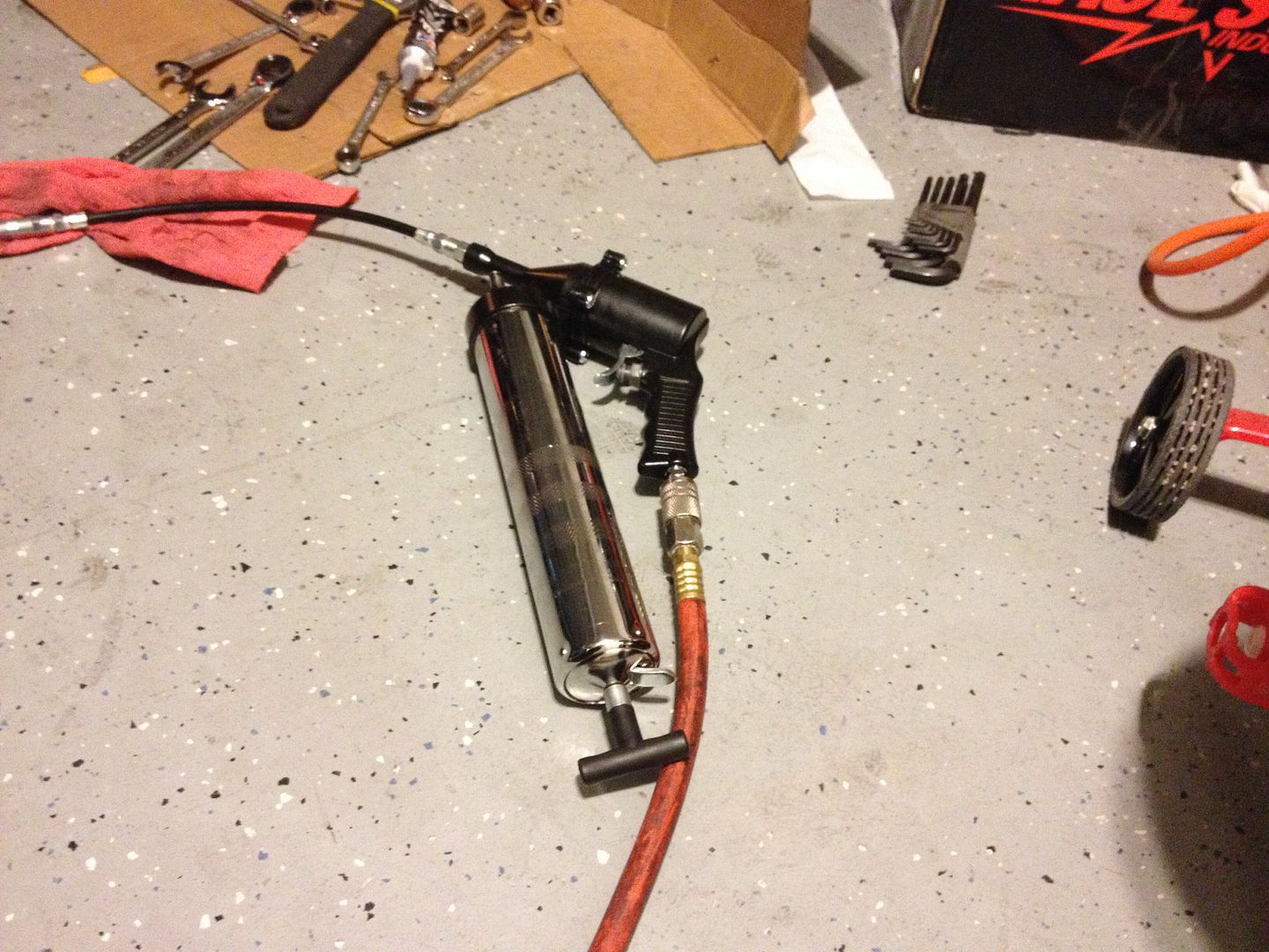

used my shiny pneumatic lube gun to grease up the chassis/suspension. I really like this thing. Probably one of my better investments.

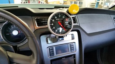

Installed an Autometer Monster Tach in my 2012 without drilling any holes in the dash panels or dash pad. It was kind of a pain in the butt because you kinda have to partially mount the console panel, and then fish the tach wires through the mount, attach the tach to the mount, and then push the console panel into its final position, but it ends up being a real clean install.
After installing it, I started the car, and determined that I should have used 1/8-inch aluminum instead of 1/16 for the panel that the tach mount is bolted to, so I'll be off to the hardware store to get some more aluminum so I can re-fab the mount panel.
