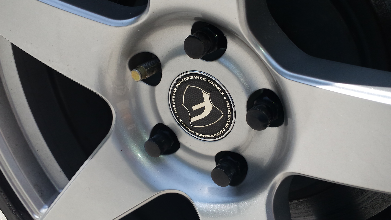

You don't need to go to an open lug nut at all. Use Gorilla racing lug nuts and they will fit the entire stud.
Here's a pic with one ARP stud visible and four Gorilla closed end extended length lug nuts...
And with one Gorilla open end extended length lug nut...
I originally bought the open end thinking the studs would protrude and once mounted, realized I could order the closed end and the wheel would look "finished" as opposed to "racecar".

Thank you for this! I was looking around just now to see what lug nuts to run. This will help out nicely. I will start looking now at how much these will run me. The great thing is I do not daily drive my car so I get to take it out maybe once or twice a month. So I have plenty of time to work all these things in and test them out to see how it all ends up. Love the Forgestar wheels.

I just checked them out and also measured my wheels which are the Boss 302 with the 3" ARP studs and I would need a enclosed lug nut that is 2.25" in length. Gorilla only has 2.10" Are you using any spacers?
Now on my back studs which are Strange axles I could use them.
