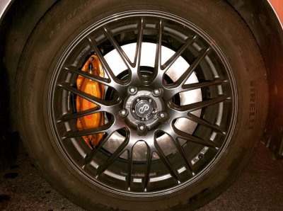

Did brake swap all around yesterday. 4 piston Brembos and rear calipers powder coated Illusion Spanish Fly. In the shade it’s Bronze, in direct light it’s Gold. Matching Centric black hat rotors and 104 series brake pads all around. Eibach 5mm spacers all around. Boss 302 brake lines.

Yes those are the 14” rotors. Why do you ask?
I was just making sure that I could not have made that sweet conversion like you did. 14" rotors won't fit in my 18" Pony package wheels so I painted my calipers and used the 13.2" rotors from the GT. They work great but they are not Brembos....

My '13 has the 14" Brembos and I'm running 18" wheels.
Your pony package wheels probably won't fit because of the caliper, not the rotors.
You either need spacers or wheels meant for an '07-'10 GT500 or '13-'14 GT with Brembos

Yes, the stock 18s won’t fit because the barrel is too small. I’m using Enkei EKM3 18x8 40 offset and 5mm spacers, just for extra clearance. I picked up the wheels used and cheap and swapped the stock Pirellis onto them as they came with winter tires. I already have winter wheels so didn’t need the tires so I sold them.
Touren TR76 will also fit. 18x8 35 offset.

Damn that is a tight fit. You sure can't say your rotors don't fill the wheel! Nice job.

Thanks. Eventually planning on 19s for the summer but that’ll be next year or the year after. So to hold me off I picked up the Enkeis just so I can get the Brembos on this year. Had them for a couple years but didn’t install them as I didn’t have wheels to accommodate for the summer. Still need to buy 1 spare 18x8 wheel with a skinny tire so in case I get a flat on a front wheel, I don’t have to switch around the wheels.

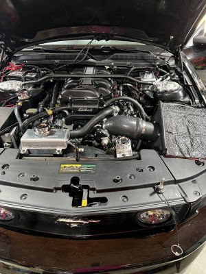

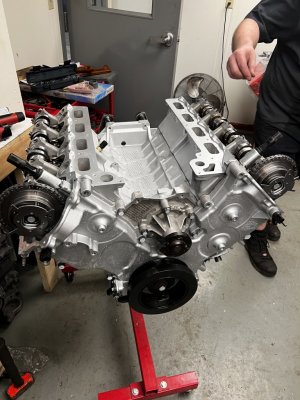

Finally got everything back together after engine rebuild with forged rods and pistons, new timing parts and valve springs. Cylinders were honed, block was line bored, and heads were lightly ported and valves reseated. I was at the limits of the engine with 500rwhp and 450 torque. Everything was done with reliability in mind as I plan on keeping the car and driving it hard for as long as I can. Once it gets broken in and dyno’ed, I’ll see if I can up the boost a bit. Another 100 miles of break in and I’ll have Lito check things out. 808EE938-340E-44FE-93EE-494D91DF069B.jpeg B4119774-F119-4597-8F75-598E0355946D.jpeg

I believe I’m in a similar spot with mine and I’m curious if you kept the stock CR or went up/down any?

We used forged pistons from DSS which resulted in a CR of 10.12:1. 6BD23B2D-6707-44A4-A38A-A32B5F7F3987.jpeg
