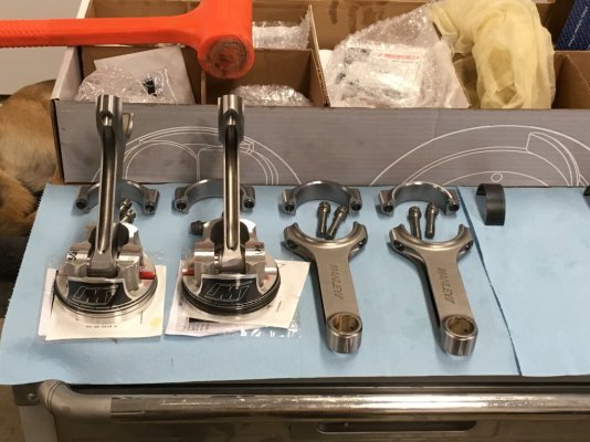

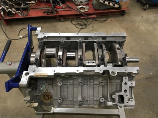

Hi Andrew. I am running the same choice of parts you listed. Manley H Beam rods on an Eagle forged crank with Wiseco forged pistons. All purchased as a balanced kit I installed in my 2010 Aluminum block. I don’t find my scribble sheet of tolerances and clearances but I did find the box tops and tech sheets from all the parts I used. The rod bearings I used are indeed Clevite H series narrowed standard size part number CB-1442HN. The Main Bearings are also the same H series standard size and included the half circle thrust bearing insert. I checked one rod and one main (dry) with plastic-gauge at assembly. I think the clearance was around 0.002” but like I said, I don’t find my note sheet.

If you haven’t done this before note that the bearings are clearanced on one side and fit into the rods only one way. This will create 4 left and 4 right clearanced rods. Good to know before mounting the pistons! I had to turn one around so look ahead. Also remember to check the actual clearance with plastigage while the bearings are clean and dry. No oil to take up space. I used ARP fasteners and torque specs on the rods, mains, side bolts and heads without the slightest problem. Have fun! :driver:
